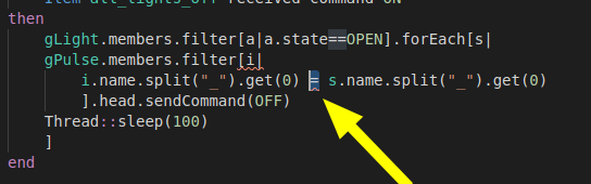

You cannot subtract strings.
Did you meant to split your string and use one or more of the parts?
EDIT - duh, forget that - I completely misread the screenshot of = for -
Ups, sorry, typo. this one is correct (I changed it also in my posting above):
i.name.split("_").get(0) == s.name.split("_").get(0)

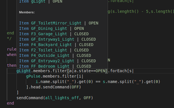

other strange behaviour
Received an output an item from a lamp on state CLOSED and the items OPEN ignored… :sweat_smile:
Ignored by what? None of the rules here would be expected to do anything about that.
the first image was a preview of glight Members , one and second item was OPEN and the others CLOSED
On second image can view item all_lights_off changed from off to on, only pulse GF_Entryway2_pulse received a command, although GF_Entryway2_Light was on state CLOSED.

I’d be more concerned about why you send commands to the same pulse Item many times. The group filter is not doing what you want. I think you are matching on the wrong parts of your name strings.
You forgot the Thread::sleep(1000) :wink:
same issue, other pulse in this case (added sleep) … and repeat the issue described from @rossko57
Crazy…

p.s: i tried the second rules wrote… doensn’t work… probably caused from members of glight.
Well, if you haven’t changed the parts of the string names that you are matching, then that result isn’t going to change.
Do you have an understanding of how to access the different parts of a string split result?
The filter does not work, obviously. But as the filter works for me :wink: … Are you sure you saved the rule?
Maybe add some logging (will emerge in openhab.log):

So, the question is: Where does the command for GF_Anteroom_Pulse come from?
Another detail: Why do you use a contact item for the *_Light Items? would be better to use Switch Items here.
Maybe I should make my hint more explict.
If you have Items named
GF_Entryway1_Light
GF_Entryway2_Light
GF_Anteroom_Light
and you split the string name at _
How many string parts will you get in your results?
What do you think results [0] will be?
Will that allow you to select just one of your Items?
