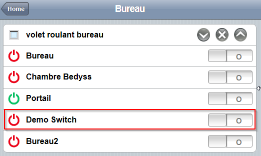

I’m beginner, I configured openhab. Things are OK when theyr are executed manually via the interface, but when I use rules nothing is happen. It seems that rules are never trigged or executed.

C:\Users\mehdi.boumaiza\OneDrive - NTT\Documents\PERSO-PRIVATE\interface-openhabe.png
