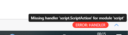

However, the strange thing is that almost all my rules are in “Invalid” state and when I Disable and then Enable them it says Error: Handler "Missin handler ‘script.ScriptAction’ for module script

openHAB 3 needs version 11, not 15. Change that first and see what happens!
From here:
Please note that versions of Java higher than 11 are not supported at the moment.
I’m running the same setup (Bullseye LXC on Proxmox) with Zulu Java 11 without issues.
My good sir/lady! You just saved my weekend! Didn’t even think the Java version could be the issue, I thought it was the minimum Java version.
