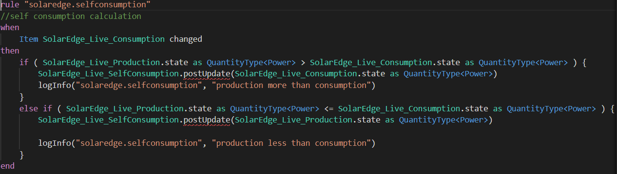

finally realized how it should looks like!
rule "solaredge.selfconsumption"
//self consumption calculation
    Item SolarEdge_Live_Consumption changed
    if ( SolarEdge_Live_Production.state as QuantityType<Power> > SolarEdge_Live_Consumption.state as QuantityType<Power> ) {
        SolarEdge_Live_SelfConsumption.postUpdate(SolarEdge_Live_Consumption.state as QuantityType<Power>)
        logInfo("solaredge.selfconsumption", "production more than consumption")
    else if ( SolarEdge_Live_Production.state as QuantityType<Power> <= SolarEdge_Live_Consumption.state as QuantityType<Power> ) {
        SolarEdge_Live_SelfConsumption.postUpdate(SolarEdge_Live_Production.state as QuantityType<Power>)
        logInfo("solaredge.selfconsumption", "production less than consumption")
Thanks everyone, sometimes VSC is showing bugs where they aren’t

What do you think are not bugs?
There is a subtlety at work in validating the postUpdate argument.
As the message told you, it looks for a state type or a Number type. A Quantity type does not meet the requirement.
As you seem to be just re-posting state anyway,
SolarEdge_Live_SelfConsumption.postUpdate(SolarEdge_Live_Consumption.state)
should satisfy the validator.
The ultimate cure-all for postUpdate pickyness is posting a string, it then (tries to) parse it into whatever is needed by the Item.
