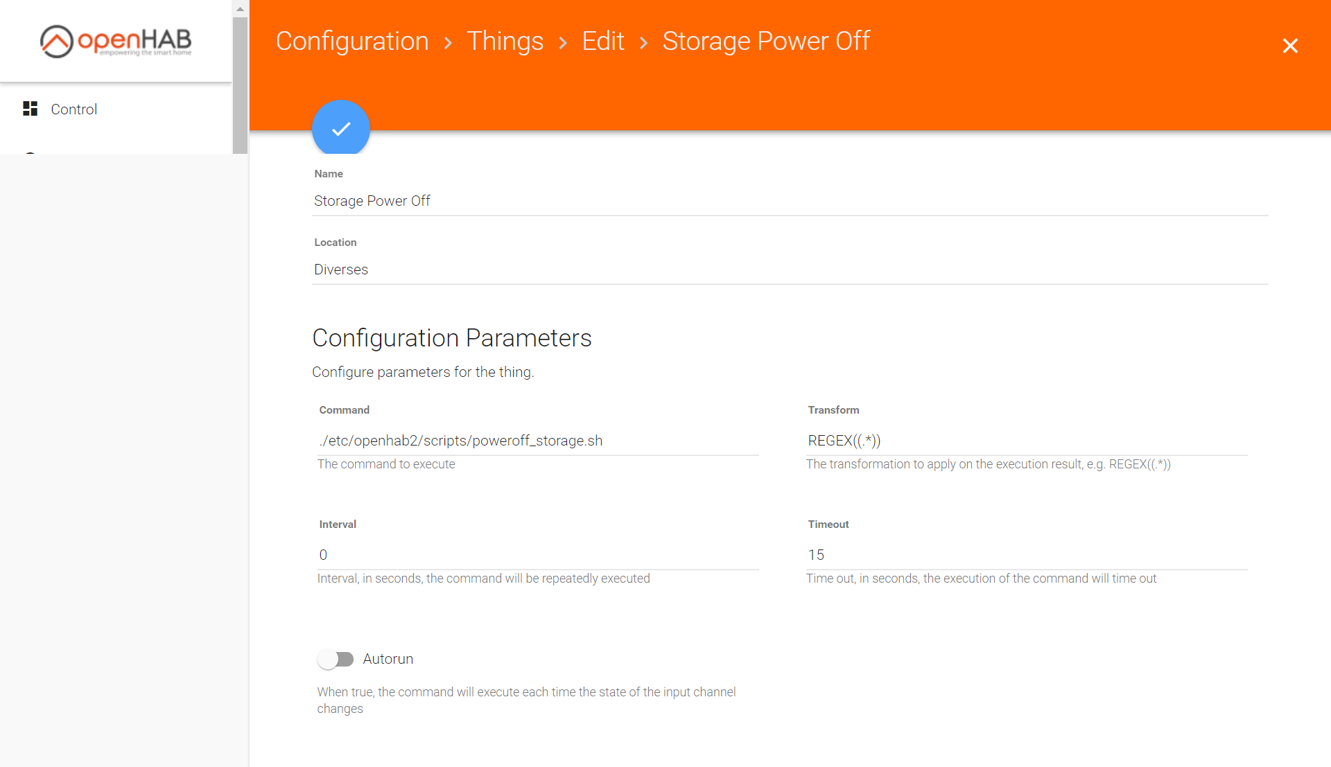

Now I installed the exec2 binding and added the command.
./etc/openhab2/scripts/poweroff_storage.sh
But how do I now create an item with paperui that makes the script run?

I don’t think that you can create Things in PaperUI for Exec2. If you go to Configuration → Things and hit the + and you don’t see Exec listed, you must use the text based .things files.
Once you have the Thing you can probably create the Item in Configuration → Items.
See http://docs.openhab.org/configuration/things.html#defining-things-using-files for how to define things in text config files. See https://docs.openhab.org/addons/bindings/exec/readme.html for how to define the Thing if you need more information on how to format the Thing.

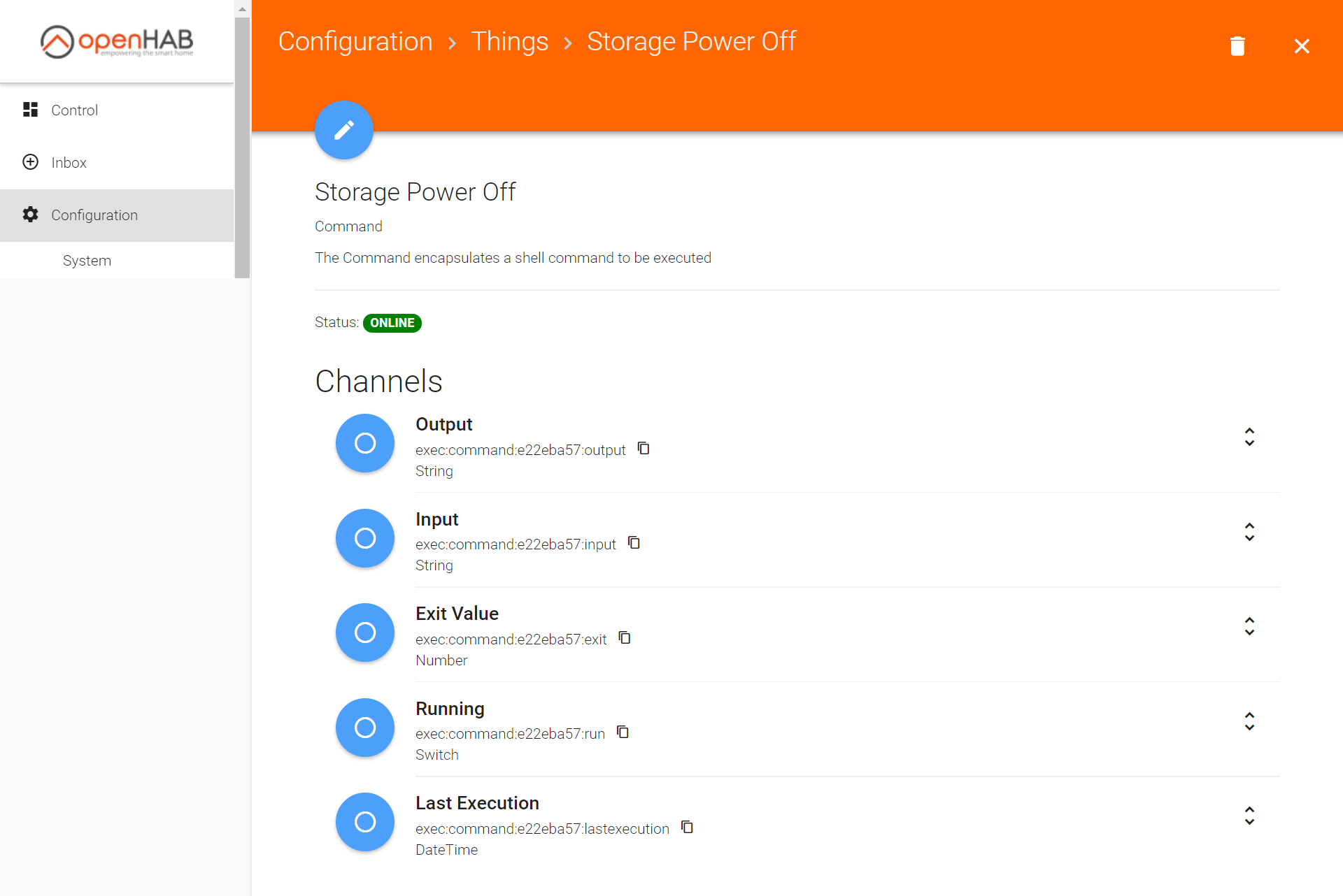

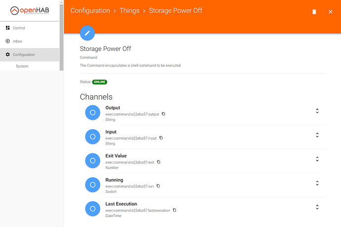

Exec is listed under “things” within the configuration.
But there is no switch to run the script.
Already tested all possible channels.

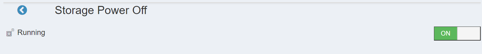

The switch is not “clickable”. I’m not able to use it.
That’s not the Item.
That’s the Thing. PaperUI only shows Things. PaperUI is not intended to be the User’s Interface for your home automation. It is an Administration UI. As such, it provides the Control section and lets you interact with SOME of your Things for testing purposes. But for this you need to create a Switch Item, put that on a Sitemap or HABPanel, and tell the Script to run from there by toggling the Item.

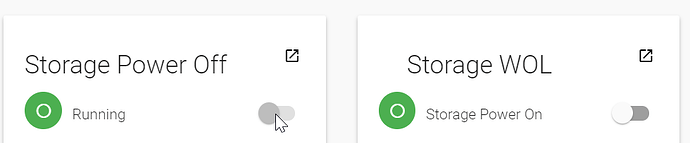

Started the item from Habmin and with the app but nothing happens…
script is running fine… tested it with the openhab user from command line. Thats the one its executed by the exec binding, isn’t it?

Yes, the openhab user is what your script will run as.
At this point my next advice is to look at
Try the various suggestions including replacing spaces with @@ and using executeCommandLine so you can see the result when the script fails.
