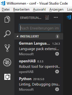

What VSC-version and oH-extension?

VSC hasn’t changed since Nov last year, is OH-extension is that one of 2.2 stable. Possible install a newer one?

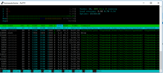

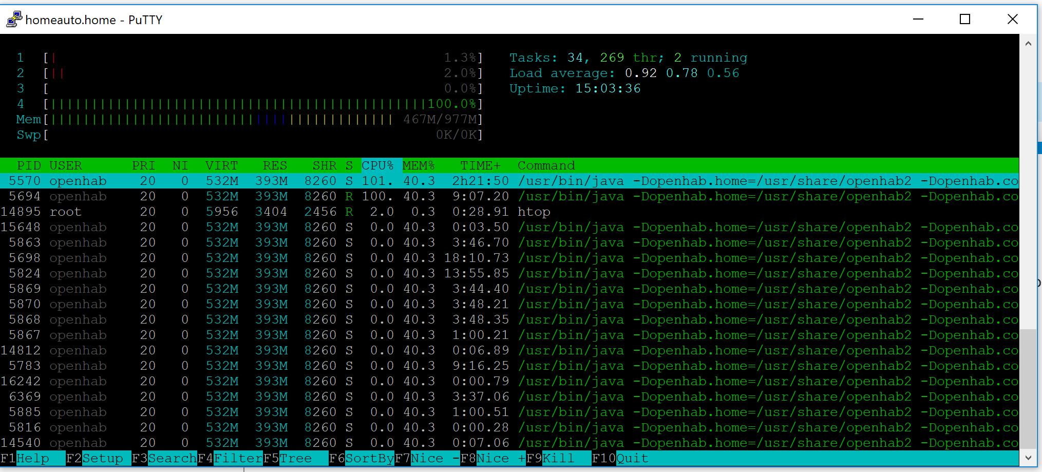

Resurrecting an old thread but I’ve now linked my performance problems (well, OH - doctor says new meds should fix mine) with VS Code.
with more frequency OH slows to a crawl. Parsing files takes - at times - a couple of minutes. Rule execution (to start the rule) is very slow.
When this happens htop shows one of the cores pegged (RPi 3B+). It’s not a hung process as it moves between cores but nonetheless, keeps one pegged.
My only ever solution was to restart the service.
This morning the same had happened. Closing VS code stopped the problem. Starting it again caused it to come back.

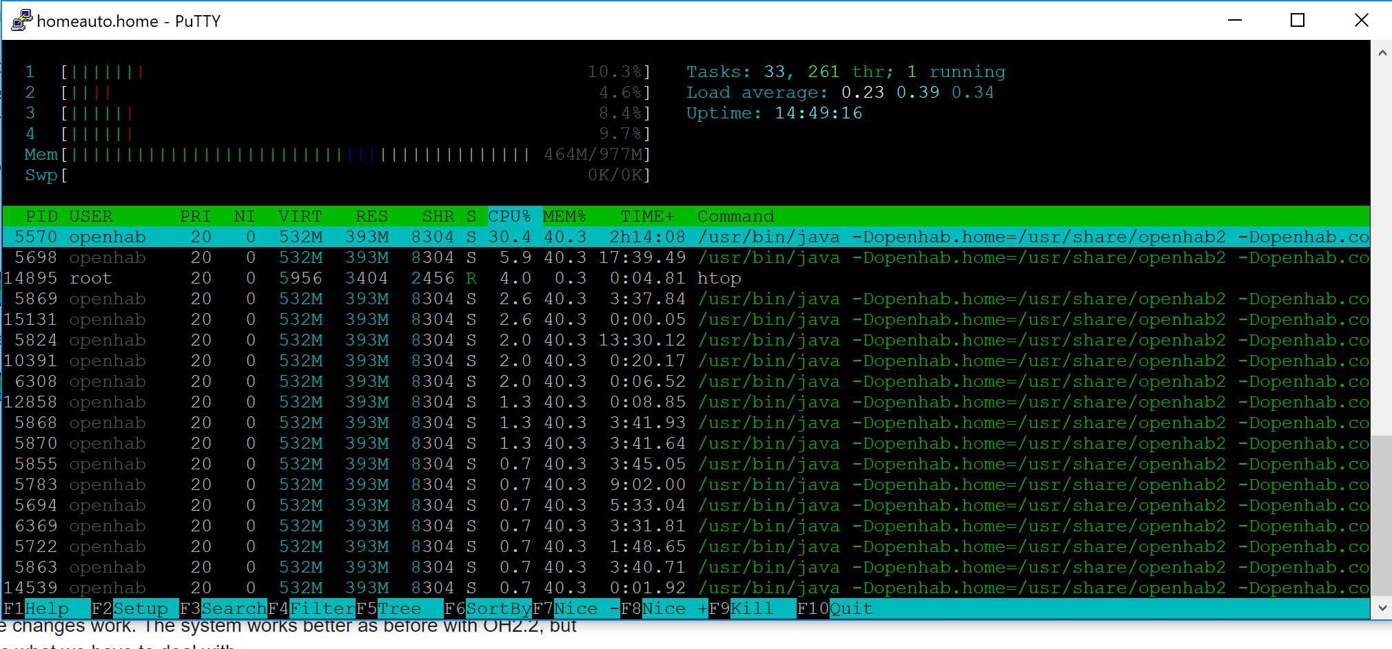

Without VS:
with VSCode (running while typing this)
Seems to be no difference between VSCode with open files and VSCode with no open files.
