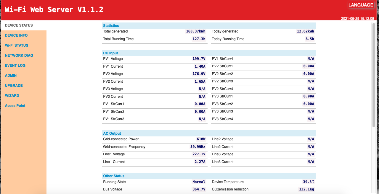

The inverter is connected at the internet by WI-FI adapter (owned solution) where I can manage by my local network (http:192.168.0.126) and also by smartphone APP.
As we don’t have biding or addons integration I’m trying to read some informations trought http:192.168.0.126/status/status.php but to be honest I don’t know how proceed.
These are the informations available accessed by local network:

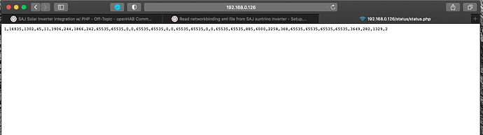

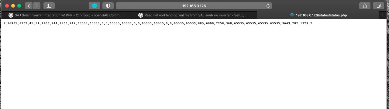

And this is the .php that I would like to read:
1,16838,1273,1263,85,2008,131,1896,234,65535,65535,0,0,65535,65535,0,0,65535,65535,0,0,65535,65535,623,5997,2267,291,65535,65535,65535,65535,3655,393,1321,2
Could anyone help me on that?

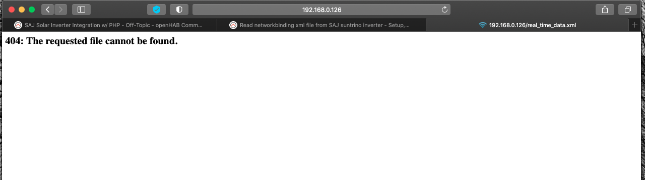

I saw your post but I cannot get any data from real_time_data… I don’t know why, but I notice some people had the same issue…
Otherwise, I’m able to get some information from /status/status.php…
http://192.168.0.126/status/status.php
Any tip?
You should be able to use the exec binding like:
wget -q -O - http://192.168.0.126/status/status.php | cut -d, -f1
to get the first result.
Instead using the http binding together with an expression you can return the individual results from the status.php returned string.
