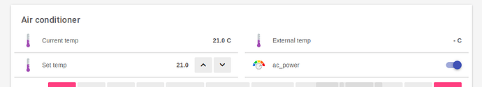

I’m trying to display external temperature along with the internal using samsung AC binding. It seems that the value is read without error and stored into ac_outdoor_temp, but it doesn’t appear in the frame. (See lines:
2019-11-17 22:35:45.969 [DEBUG] [.samsungac.internal.SamsungAcBinding] - Trying to find item for: Salon and cmd: AC_OUTDOOR_TEMP
2019-11-17 22:35:45.969 [DEBUG] [.samsungac.internal.SamsungAcBinding] - ac_outdoor_temp gets updated to: 54
Any idea on how to display AC_OUTDOOR_TEMP value?

If I add a rule to dump the value, then the debug message is never displayed.
$ cat rules/samsunac-ext-temp.rules
rule ExternalTemperatureDecimalInputs
  Item ac_outdoor_temp changed // or Item kodi_kodi_337f8b28_currenttime changed
  ac_outdoor_temp.postUpdate(ac_outdoor_temp.state)
  logDebug("test", "ac_outdoor_temp received: "+ac_outdoor_temp.state)
And if I enable the or Item kodi_kodi_337f8b28_currenttime changed I get:
==> openhab.log <==
2019-11-17 22:45:13.368 [DEBUG] [.eclipse.smarthome.model.script.test] - ac_outdoor_temp received: NULL
Thanks for your help :slight_smile:
According to the docs this command is not supported
Hi @vzorglub,
thanks for your response. I suspect the doc does not reflect the actual code of the binding. Maybe @steintore is around to confirm?
Looking at file openhab1-addons/bundles/binding/org.openhab.binding.samsungac/src/main/java/org/openhab/binding/samsungac/internal/SamsungAcBinding.java at main · openhab/openhab1-addons · GitHub the log I get for it let me think it is parsed by the binding
As there is a default in the switch case conditions, and the log from line 375 is the one I get for this value.
Bests
