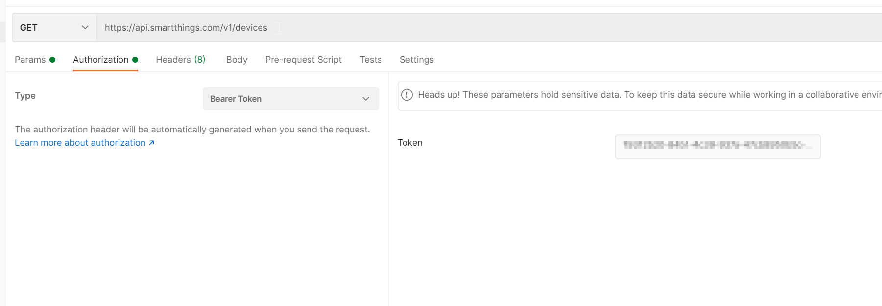

GET
URL: https://api.smartthings.com/v1/devices
Tab Authorization - Type - Bearer Token - add your personal Token
It should look like this:
  • Click SEND
As a result you should get in the “body section” all your devices listed.
Copy all the Device ID´s and save it.

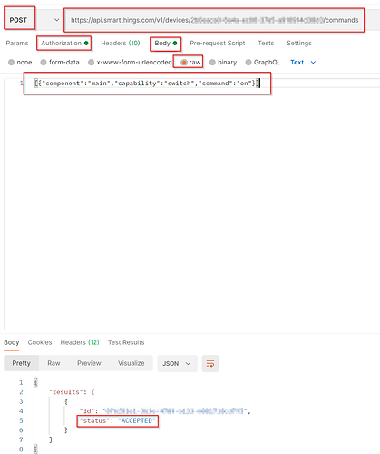

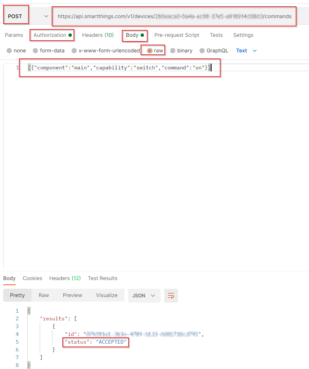

So for an example this is how to switch your AC on with Rest API:
Method: POST
URL: https://api.smartthings.com/v1/devices/yourDeviceID/commands
Don´t forget to add your Authorization bearer
Add the capability under “Body” Tab:
[{“component”:“main”,“capability”:“switch”,“command”:“on”}]
Click SEND to submit your request.
So that´s the first step to get the integration into OH. If this step is working you should be safe to continue.

I was able to run the GET command, as you explained, and get my devices ID’s.
However, when I tried to follow your next step and run POST, I got the following error message.
Screen Shot 2021-06-27 at 12.12.56
Did I do something wrong?
Please check the quotes ” - while using copy / paste the format often gets corrupted.
Im only on my mobile phone and that’s the only thing I can see at the moment.
Amazing! You were right :pray: :pray:
Once I deleted and re-entered all the quote " symbols in the body text, the command worked properly.

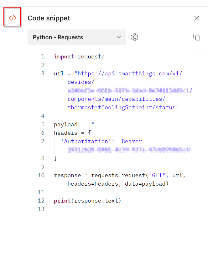

In my case I converted the Rest API commands with Postman to Python language. You can also use http Binding to achieve this but I decided to go with python.
To do so open the Code snippet (located top right corner) and choose your output format.

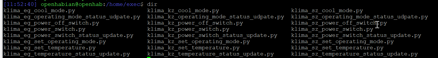

Copy this and create the python scripts directly on your OH installation.
I created a folder and adjusted the authorizations so that the user which is running Openhab is able to launch the python scripts:

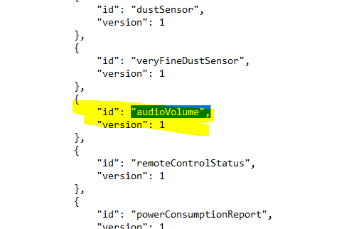

For your question, have a look into the first postman Code which includes your ID, it also shows below that in the code all channels available.
Then cross reference them with Mario’s link to the API in his first post and you can identify the commands to send to each channel.

Attributes of the API:
Thanks :pray:
Should the command be something like this?
(this one didn’t work): [{“component”:“main”,“capability”:“audioVolume”,“command”:“setVolume(volume)”,“arguments”:[“0”]}]
Looks about right if I understand the API and Mario’s examples well enough.
