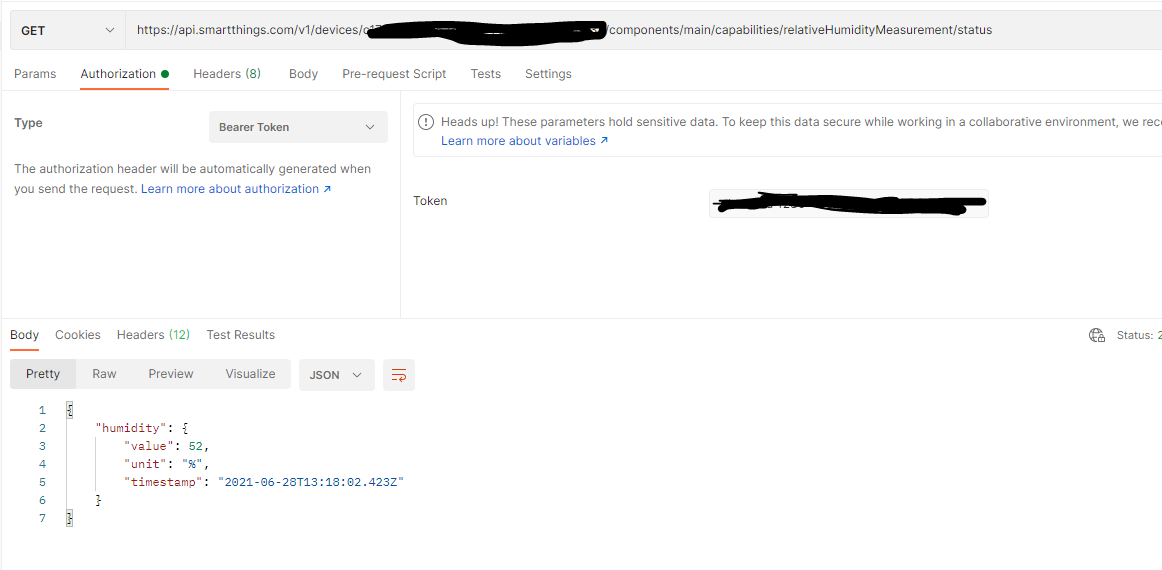

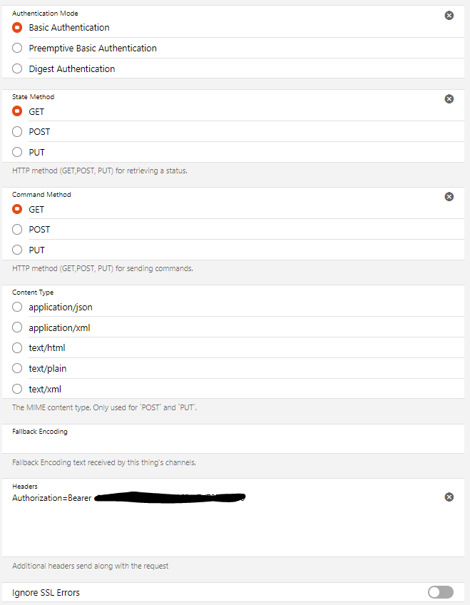

Just did a quick example for humidity:
https://api.smartthings.com/v1/devices/deviceID/components/main/capabilities/relativeHumidityMeasurement/status
Gives me following output:
    "humidity": {
        "value": 52,
        "unit": "%",
        "timestamp": "2021-06-28T13:18:02.423Z"
Cannot do a command right now as the aircon is in use, but will try tomorrow and report back.
Did you run this command in Postman with GET?
And this was the output you received?
I tried to run the same command you shared as a GET command (with my deviceID), but I got this output:
    "humidity": {
        "value": 0,
        "unit": "%",
        "timestamp": "2021-06-28T13:59:03.453Z"
Yes, GET URL. Your output seems to be correct, just that the humidity is currently measured with 0.
I assume your AC is turned on and humidity is not 0 though right? :slight_smile:
Correct. My AC was on when I ran the GET URL, and humidity was most likely not 0 :slight_smile:
Maybe it takes a few minutes from the moment the AC powers ON till the humidity sensor takes a reading?
The humidity is not measured while using cool mode afaik. Try to switch to dry mode and run the command again.

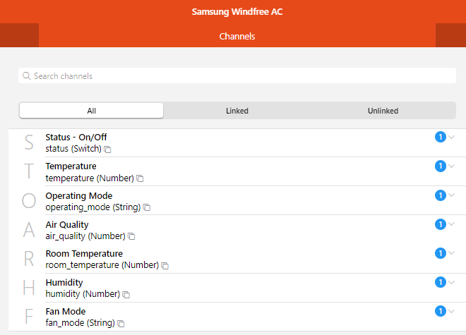

Okay guys here´s party three:

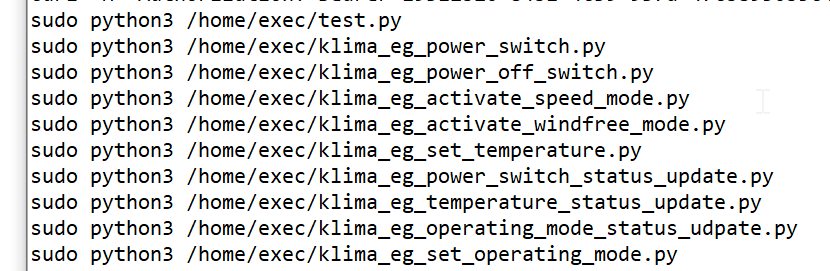

First install the EXEC binding in Openhab:

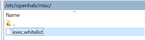

Also make sure to whitelist your Exec commands in the following file: (whitelist is an “old” version here - I ´m working with input arguments while using the python scripts already…)
I´m not 100% sure but I tried wildcards and it wasn´t working for me.

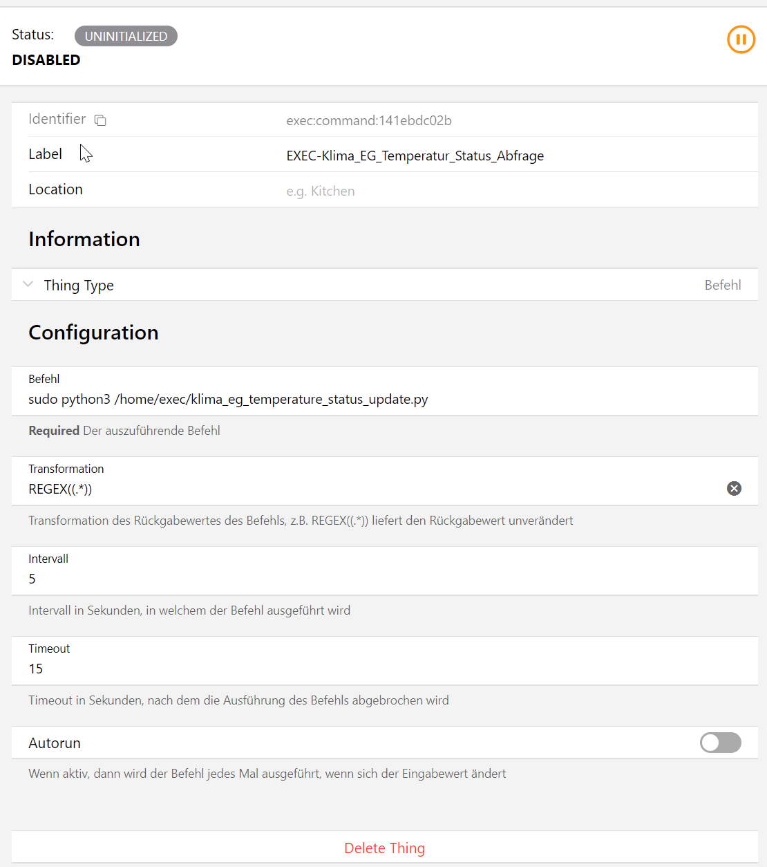

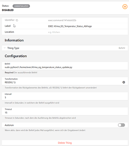

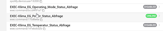

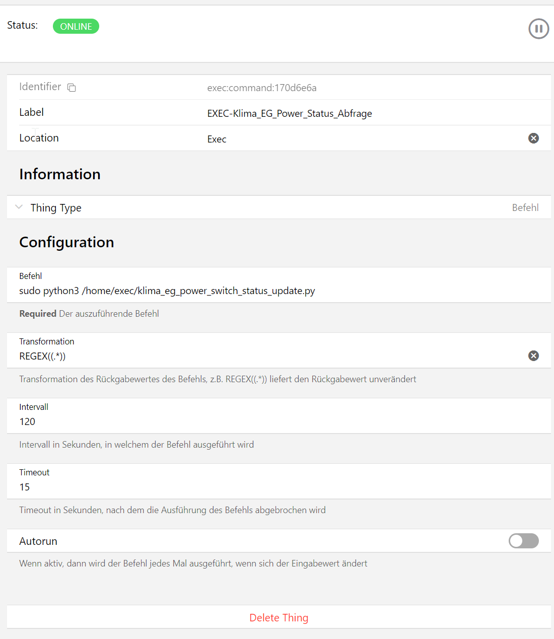

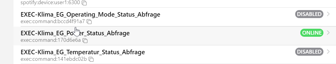

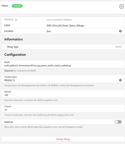

Next step is to create the exec binding things. I created 3 thinkgs for each AC unit.
One is checking the Power status. The other one´s are disabled (to reduce “noise” in my logging) and only gets activated if the AC unit is powered on.
I´m checking every 2 minutes if the device is ON.
If the AC unit is on - the “Status update” things gets active (through my rule) and then updates the temperature / operating mode status every 5 seconds.
EDIT: If you want to use python with input arguments (not having a script for setting temperature to 21 degree and another script to set the temperature to 22 degree) you can use the following example:
payload = "[{\"component\":\"main\",\"capability\":\"thermostatCoolingSetpoint\",\"command\":\"setCoolingSetpoint\",\"arguments\": ["+ temp +"]}]"
The argument will then be “filled” with the following example:
sudo python3 /home/exec/klima_eg_set_temperature.py 21.0
…as 21.0 is the input argument!
Next will be creating all the Items and finally the rules!
Last but not least: I know that my solution is (as I already mentioned) not state of the art and maybe the choice to use python (instead of http) is bad but for me it was easier to use as I was not able to use http binding with authorization bearer and so on…
Always open minded for tips / advices to improve my solution.
You are correct. Under Dry mode the humidity status GET URL command works :pray:

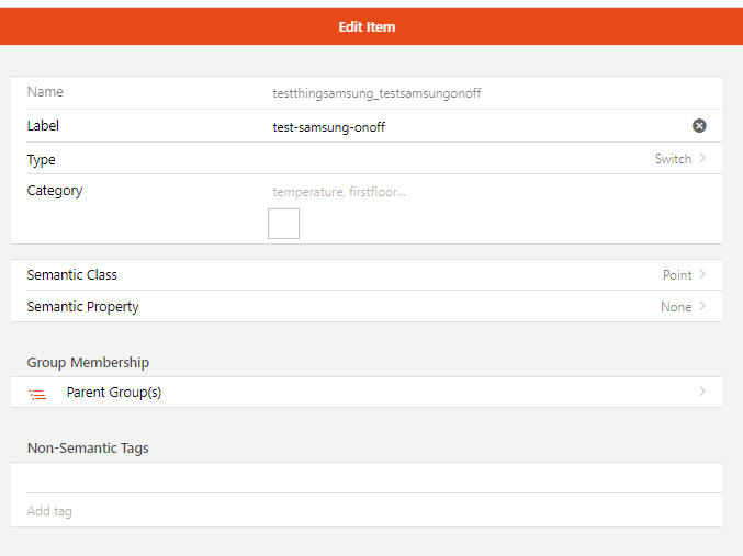

Alright guys - here are my items for the AC units.
I simply linked the EXEC Thing channels to my items (most of it, some of them are only just holding status information):
//Aktualisiert den Status der Klimaanlage (ON = Abfrage läuft bei smartthings API, OFF = idle)
Switch                Klima_Essbereich_Switch_Akt          "Klima Essbereich aktualisieren"                                      {channel="exec:command:170d6e6a:run"}
Switch                Klima_Schlafzimmer_Switch_Akt        "Klima Schlafzimmer aktualisieren"                                    {channel="exec:command:a60269bec2:run"}
Switch                Klima_Kinderzimmer_Switch_Akt        "Klima Kinderzimmer aktualisieren"                                    {channel="exec:command:13d71ac329:run"}
//zeigt aktuellen Power Status an (on / off), Input kommt von smartthings API
String                Klima_Essbereich_Switch_Status       "Klima Essbereich"                                                    {channel="exec:command:170d6e6a:output"}
String                Klima_Schlafzimmer_Switch_Status     "Klima Schlafzimmer"                                                  {channel="exec:command:a60269bec2:output"}
String                Klima_Kinderzimmer_Switch_Status     "Klima Kinderzimmer"                                                  {channel="exec:command:13d71ac329:output"}
//zeigt/aktualisiert aktuellen Temperaturwert (Setpoint) vom Klimagerät an
Switch                Klima_Essbereich_Temp_Akt            "Klima Essbereich Temperatur aktualisieren"
String                Klima_Essbereich_Temp_Status         "Klima Essbereich Temperatur"
Switch                Klima_Schlafzimmer_Temp_Akt          "Klima Schlafzimmer Temperatur aktualisieren"                         {channel="exec:command:66af9ff7ee:run"}
String                Klima_Schlafzimmer_Temp_Status       "Klima Schlafzimmer Temperatur"                                       {channel="exec:command:66af9ff7ee:output"}
Switch                Klima_Kinderzimmer_Temp_Akt          "Klima Kinderzimmer Temperatur aktualisieren"                         {channel="exec:command:22e78796b8:run"}
String                Klima_Kinderzimmer_Temp_Status       "Klima Kinderzimmer Temperatur"                                       {channel="exec:command:22e78796b8:output"}
//zeigt/aktualisiert aktuellen Kühlmodus an (Fast, Windfree, Normal, ...)
Switch                Klima_Essbereich_Op_Mode_Akt         "Klima Essbereich Operating Mode aktualisieren"
String                Klima_Essbereeich_Op_Mode_Status     "Klima Essbereich Operating Mode"
Switch                Klima_Schlafzimmer_Op_Mode_Akt       "Klima Schlafzimmer Operating Mode aktualisieren"                     {channel="exec:command:0d945c8ca4:run"}
String                Klima_Schlafzimmer_Op_Mode_Status    "Klima Schlafzimmer Operating Mode"                                   {channel="exec:command:0d945c8ca4:output"}
Switch                Klima_Kinderzimmer_Op_Mode_Akt       "Klima Kinderzimmer Operating Mode aktualisieren"                     {channel="exec:command:0c5415beb6:run"}
String                Klima_Kinderzimmer_Op_Mode_Status    "Klima Kinderzimmer Operating Mode"                                   {channel="exec:command:0c5415beb6:output"}
//Power Switches
Switch                Klima_EG_Switch                      "Klima EG"
String                Klima_EG_Temp                        "Klima EG Temperatur %s"                             <temperature>
Switch                Klima_SZ_Switch                      "Klima SZ"
String                Klima_SZ_Temp                        "Klima SZ Temperatur %s"                             <temperature>
Switch                Klima_KZ_Switch                      "Klima KZ"
String                Klima_KZ_Temp                        "Klima KZ Temperatur %s"                             <temperature>
//Kühlmodus (Windfree, Normal, Windfreesleep,...)
Number                Klima_EG_Mode                        "Klima EG Modus"
Number                Klima_SZ_Mode                        "Klima SZ Modus"
Number                Klima_KZ_Mode                        "Klima KZ Modus"
//Setpoint per Sitemap für Ziel-Temperatur Einstellung
Number:Temperature    Klima_EG_Setpoint                    "Klima EG Setpoint [%.1f]"                           <temperature>
Number:Temperature    Klima_SZ_Setpoint                    "Klima SZ Setpoint [%.1f]"                           <temperature>
Number:Temperature    Klima_KZ_Setpoint                    "Klima SZ Setpoint [%.1f]"                           <temperature>

rule "Check Klima EG Temperatur"
when Item Klima_Essbereich_Temp_Status changed or
Item Klima_Essbereich_Temp_Akt changed
Klima_EG_Temp.postUpdate(Klima_Essbereich_Temp_Status.state.toString.substring(28,32))
//Setpoint Temperatur an Klimaanlage EG übergeben
rule "Setpoint Temp an Klimaanlage EG uebergeben"
when Item Klima_EG_Setpoint changed
if (Klima_EG_Setpoint.state == 20.0 | °C || Klima_EG_Setpoint.state == 20.5 | °C) {
executeCommandLine("sudo", "python3", "/home/exec/klima_eg_set_temperature.py" ,"20.0")
if (Klima_EG_Setpoint.state == 21.0 | °C || Klima_EG_Setpoint.state == 21.5 | °C) {
executeCommandLine("sudo", "python3", "/home/exec/klima_eg_set_temperature.py" ,"21.0")
if (Klima_EG_Setpoint.state == 22.0 | °C || Klima_EG_Setpoint.state == 22.5 | °C) {
executeCommandLine("sudo", "python3", "/home/exec/klima_eg_set_temperature.py" ,"22.0")
if (Klima_EG_Setpoint.state == 23.0 | °C || Klima_EG_Setpoint.state == 23.5 | °C) {
executeCommandLine("sudo", "python3", "/home/exec/klima_eg_set_temperature.py" ,"23.0")
if (Klima_EG_Setpoint.state == 24.0 | °C || Klima_EG_Setpoint.state == 24.5 | °C) {
executeCommandLine("sudo", "python3", "/home/exec/klima_eg_set_temperature.py" ,"24.0")
if (Klima_EG_Setpoint.state == 25.0 | °C || Klima_EG_Setpoint.state == 25.5 | °C) {
executeCommandLine("sudo", "python3", "/home/exec/klima_eg_set_temperature.py" ,"25.0")
//executeCommandLine("sudo", "python3", "/home/exec/klima_eg_set_temperature.py" ,Klima_EG_Setpoint.state.toString)
logInfo("INFO", "Klima EG Setpoint:" + Klima_EG_Setpoint.state.toString)
//eingestellter Kühlmodus vom Klimagerät auslesen
rule "Check Klima EG Mode"
when Item Klima_Essbereich_Op_Mode_Akt changed
var mode_eg = Klima_Essbereeich_Op_Mode_Status.state.toString.substring(154)
if (mode_eg.contains("off")) {
    Klima_EG_Mode.postUpdate(0)
if (mode_eg.contains("windFree")) {
    Klima_EG_Mode.postUpdate(1)
if (mode_eg.contains("speed")) {
    Klima_EG_Mode.postUpdate(2)
if (mode_eg.contains("windFreeSleep")) {
    Klima_EG_Mode.postUpdate(3)
//Operating Mode an Klimaanlage von Openhab übergeben
rule "Operating Mode an Klimaanlage EG uebergeben"
when Item Klima_EG_Mode changed
if (Klima_EG_Mode.state == 0)
executeCommandLine("sudo", "python3", "/home/exec/klima_eg_set_operating_mode.py", "off")
else if (Klima_EG_Mode.state == 1)
executeCommandLine("sudo", "python3", "/home/exec/klima_eg_set_operating_mode.py", "windFree")
else if (Klima_EG_Mode.state == 2)
executeCommandLine("sudo", "python3", "/home/exec/klima_eg_set_operating_mode.py", "speed")
else if (Klima_EG_Mode.state == 3)
executeCommandLine("sudo", "python3", "/home/exec/klima_eg_set_operating_mode.py", "windFreeSleep")
//Things Auto Status Update (Power, Mode, Temp) deaktivieren/aktivieren um unnötige Systemlast/Log Einträge zu verhindern
rule "Things Klima EG Status Update steuern"
when Item Klima_EG_Switch changed
if (Klima_EG_Switch.state == ON) {
sendHttpPutRequest("http://192.168.1.199:8080/rest/things/exec%3Acommand%3Abccd4f91a7/enable", "application/json", 'true', headers, 1000)
sendHttpPutRequest("http://192.168.1.199:8080/rest/things/exec:command:141ebdc02b/enable", "application/json", 'true', headers, 1000)
if (Klima_EG_Switch.state == OFF) {
    sendHttpPutRequest("http://192.168.1.199:8080/rest/things/exec%3Acommand%3Abccd4f91a7/enable", "application/json", 'false', headers, 1000)
    sendHttpPutRequest("http://192.168.1.199:8080/rest/things/exec:command:141ebdc02b/enable", "application/json", 'false', headers, 1000)

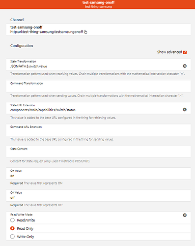

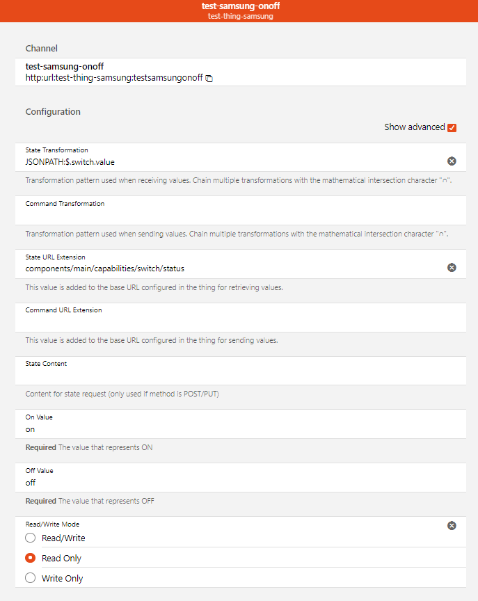

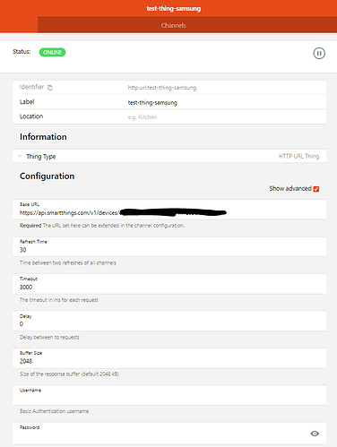

Hi @Mario084 and @mjeshurun,
Just to report back on progress as I am investing some time today.
Below an example using the HTTP binding and “GET”'ing the AC status:
HTTP Thing Definition
Replace the black bars with your deviceID and token.
Channel
Item
Channel & Item is pretty straight forward.
