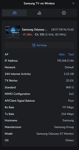

Hi All, using 5.1.0 and can get the unit to switch off fine via alexa. I moved from Ethernet over to WIFI because of the bug (LLM says there is) , updated my MAC address and disabled/renabled the power settings and Remote Control etc. I can switch OFF fine.
I can’t switch on. All devices on the local lan, running OH on a VM. No firewall.
Any suggestions? This is what the debug shows:
