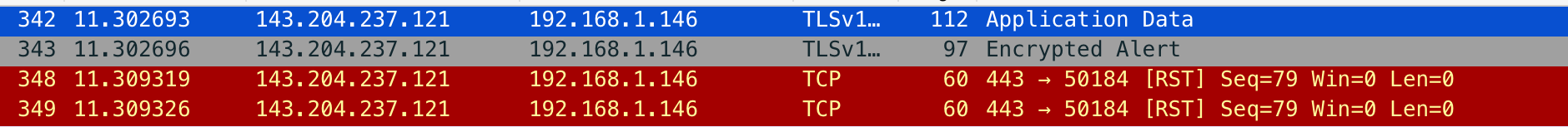

When a command is sent to the Vacuum, via the app, can you capture the message with something like wireshark? Is the message encrypted? If not encrypted try getting all the commands then use OH to send the info. Is there an API for this vacuum?
I will try capture it through wireshark and see if it is encrypted or not :wink: .. There seems to be an API but as far as I can tell it is a closed API that is only available through signup as partner developer : SmartThings | Samsung Developers
If it’s free, look into signing up as a developer and see what you can gain.
Unfortunately the data being send is encrypted (See screenshot)
