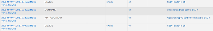

SmartThings hub events:
But on the 2nd attempt it’s not switched off.
