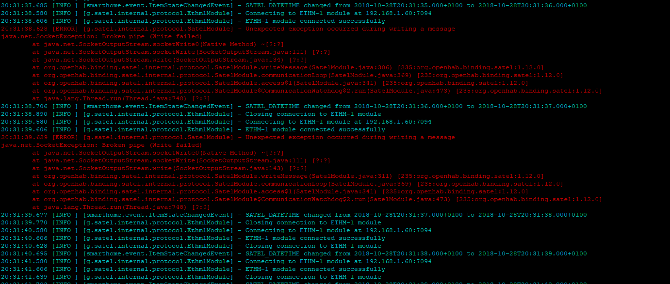

I installed Satel Action, but now I’ve this log (periodically):
Can’t read that,
Copy and paste the log using How to use code fences
20:35:32.370 [INFO ] [smarthome.event.ItemStateChangedEvent] - SATEL_DATETIME changed from 2018-10-28T20:35:29.000+0100 to 2018-10-28T20:35:30.000+0100
20:35:35.271 [INFO ] [g.satel.internal.protocol.Ethm1Module] - Connecting to ETHM-1 module at 192.168.1.60:7094
20:35:35.338 [INFO ] [g.satel.internal.protocol.Ethm1Module] - ETHM-1 module connected successfully
20:35:35.404 [ERROR] [g.satel.internal.protocol.SatelModule] - Unexpected exception occurred during writing a message

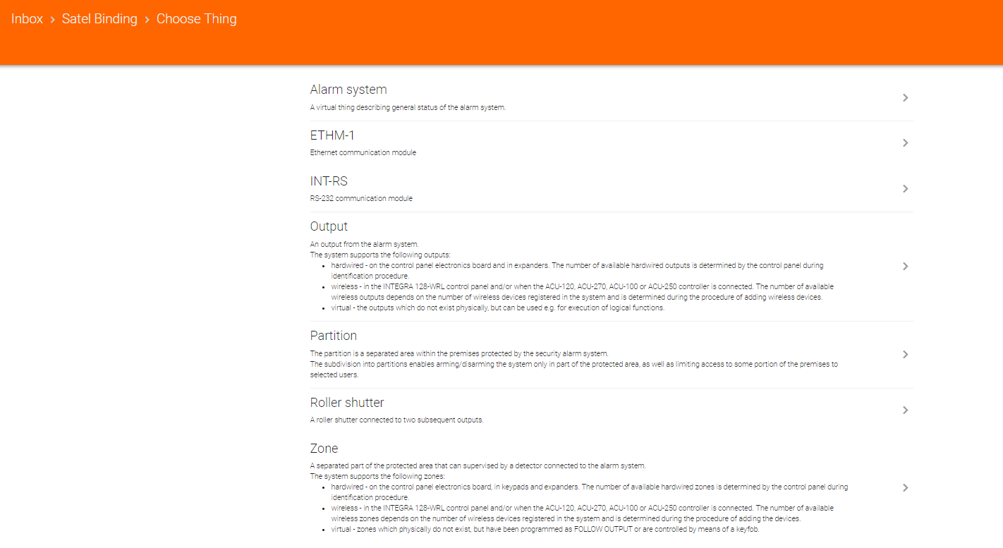

You can configure the binding either in the files or in PaperUI - what is more convenient for you.
If you choose PaperUI you can add the thing manually or make discovery for the binding. It should appear as one of the first discovered things.

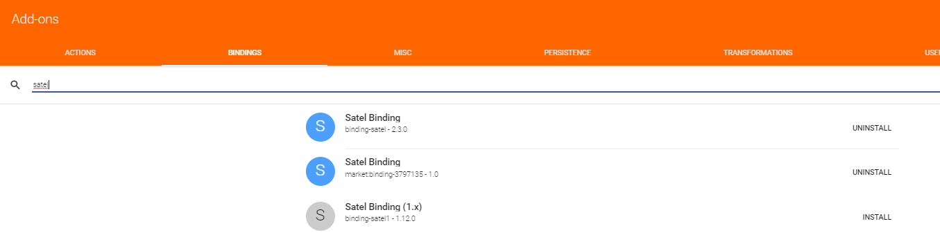

In Paper UI (manual mode) I cannot see " event-log" object
Then you don’t have the marketplace version installed on your system. Please double check you installed correct version and you don’t have satel binding in addons.cfg.

I just realized that you have both Satel bindings installed - one from OH installation and another one from the Marketplace. You must remove the first one and then try to add Event Log thing.
PERFECT!!!
Thanks very much!!!
