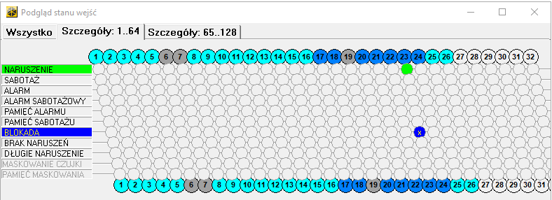

Hi druciak.
I have a problem with the zone status.
If the zone is bypassed, the violation status is not presented.
If I have an open window and I want to activate the alarm, I block the zone, so in OH I do not see the status whether the window is open or closed.
In DLOADX, the violation status is displayed irrespective of the bypass.
Hi Patyk.
Have you checked debug logs, what comes from the system?
It would be easier to understand where the problem is with the logs, I don’t think it will be easy to reproduce this behavior on my system.
