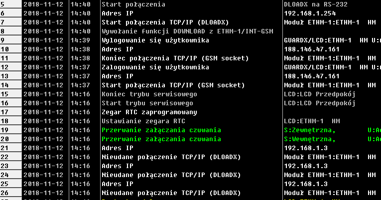

OKAY. So I tried to connect via DLOADX app - with success:
Tried to ping the ETHM-1 - success. But when trying to telnet 192.168.1.112 7090 it says the connection is refused… Even after restarting both Satel and OH@RasPi… Even tried to connect when Service Mode on Satel was on… Nothing…
On DLOADX Events List there is the entry that my RasPi’s IP (192.168.1.3) was connecting, but it failed (my comp’s IP: 192.168.1.254):
Why is that? The port is OK, the IP is okay as well. It was working for months, and now it stopped… :\
There are 3 cases:
  1. You bridge configuration is wrong.
  2. You have something already connected to ethm-1 on the same port - other version of the binding, other oh installation, etc.
  3. Your ethm-1 hanged on some other connection that is already terminated, but the module doesn’t know about it. This is the worst case and the only thing you can do unlock communication is to powercycle the module. You could also try to unplug it from your network.

Well… I think that was the case… Unplugged network cable od the module, waited a minute, re-plugged in. And it didn’t actually help.
So I halted the openHAB service, cleared cache, waited 20 minutes, restarted service and… here it is:
