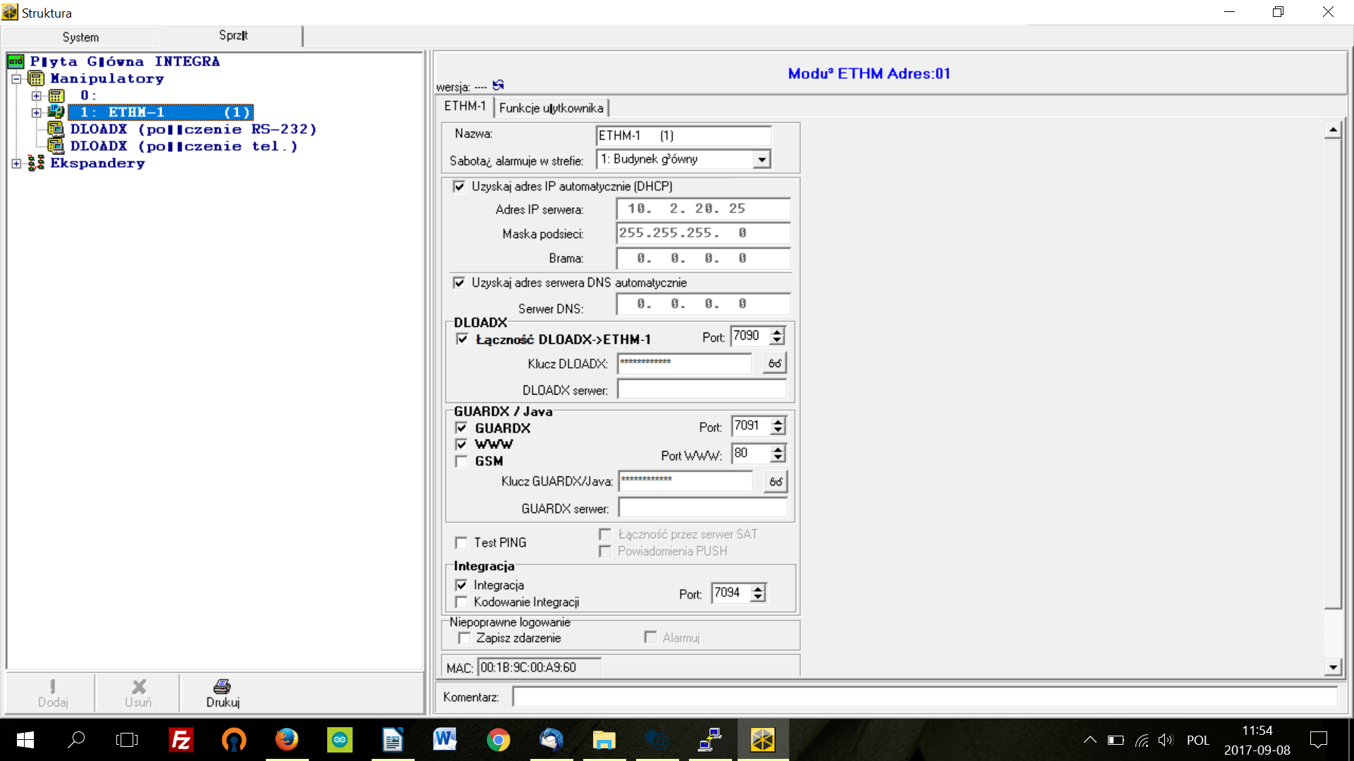

Below my settings for Satel in Dloadx which is app to configure Satel:
check connection from server where you have OpenHAB by using ping and scan if you can see open port 7094 by nmap , in my example it will be:
sudo nmap -sS 10.2.20.25/32

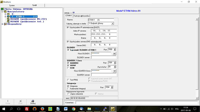

Here you go :), I changed my previous post .
nmap command not found in console
Status: UNINITIALIZED - HANDLER_REGISTERING_ERROR org.eclipse.smarthome.core.thing.internal.ThingImpl cannot be cast to org.eclipse.smarthome.core.thing.Bridge - this is information in openhab
What kind of system you use for OpenHAB ?
Works like a charm
. Well done druciak ![]()
Okay, got connected to the “satel”, but I had to reboot the system. I could not uninstall the previous version of bindings satellite 1.10.
