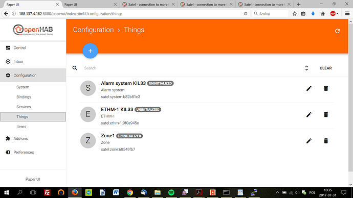

OK. How to add another Satel alarm system ? OK, I just added new thing I can add ETHM-1 once and then I can add another ETHM-1 , so it seems to be fine but I have uninitialized status.
I had to run new openHAB server because I couldn’t uninstall previous Satel binding, when I started from fresh installation it works well :slight_smile:
