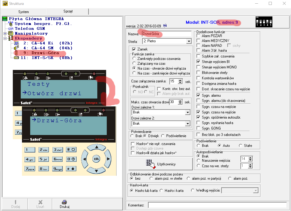

My problem is that I do not know how to identify these doors in item definition.
In the Satels nomenclature they are identified by expander name - they do not have a number assigned to it (such as input or output). Expander has only his name and address (it does not work - I tried).

Regarding your doors - you need to find in dloadx what is your doors number, for example in output/timers/doors state view, shortcut is Ctrl+Y. There should be at least one doors available, but again I don’t have this module, so I am just guessing. Having doors number it will be quite easy to define an item for them. Once doors control is implemented in the binding, you will be able to open them using OH.
Had a one more look at the docs and it seems for doors you need to specify expander’s address. So in your case it should be ‘9’.
