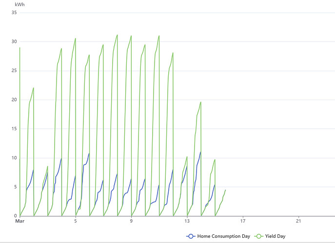

I only want to save and plot the maximum value for an item per day. How can I realise this?
To make it more plastical: I have the photovoltaic production and electric consumption of a plenticore inverter. The plotted values look like this:
