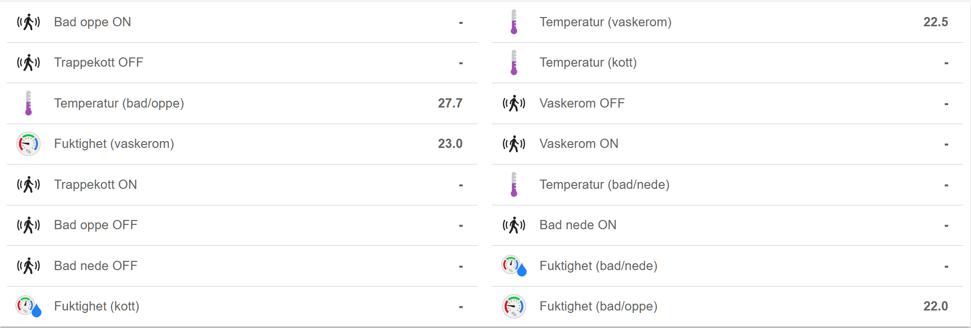

Even minor editing in my .items file such as ‘labeltext’ or ‘iconname’ in Eclipse SmartHome Designer renders group-items in my sitemap shuffled when viewed in Basic UI or HabDroid.
Also happens after defining new items.
After a restart, the proper ordering is restored.
After a restart:
After saving just an extra space character in the .items file:
