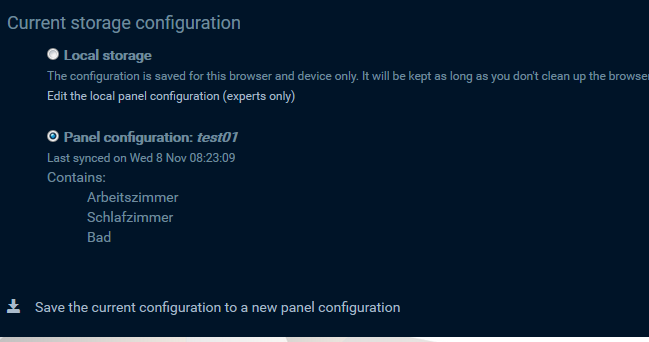

After i have done my first panel configuration i now want to save it to access it from my tablet.
The problem is, that the panel configuration ist not saved successfully.
I have tried the following:
  • in Habpanel (on my computer) go to settings and click on Save the current configuration to a new panel configuration, i entered a name and cklicked on ok.
  • the configuration should now be saved
  • next I go to my tablet and try to load that configuration, but there is only the option for the local storage
  • when i now log of from myopenhab on my computer and login again, the saved configuration is also not there.
