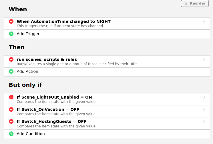

Just out of curiousity, how do handle enabling and disabling scenes?
I have one additional switch item for each scene. In the rule that calls the scene to run, that switch item is checked in the rule conditions. So if the switch is off, the scene will not be activated even if the other triggers for the rule do occur. (In fact, I have several such items as there are also generic times when whole batches of scenes are disabled such as when the family is on vacation.)
You can also, if you prefer, use rules to control whether other rules (including scenes) are enabled or disabled via the rule actions.
