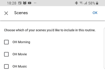

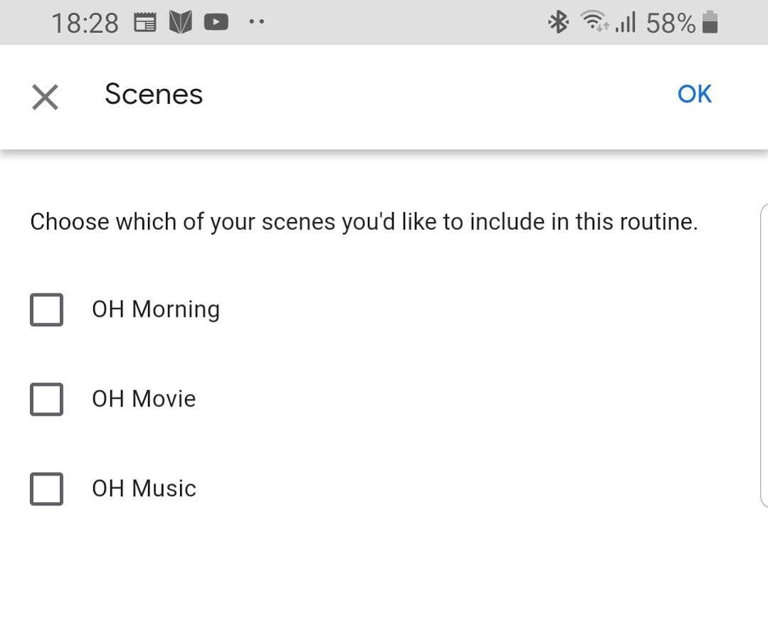

@soyxan, Openhab items (switches exactly) tagged with ["Scene"] are visible in Google Home app under Routines → Add Action (Browse popular actions tab) → Adjust scenes:
Items file:
Switch  GHS_Movie       "OH Movie"      ["Scene"]
Switch  GHS_Morning     "OH Morning"    ["Scene"]
Switch  GHS_Music       "OH Music"      ["Scene"]
So you can include them in defining Routines in Google Home app and in Openhab create rules triggered by Scene items.
