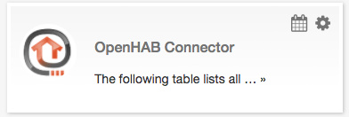

I had an idea, something strange keeps happening inside ZWay with the openHAB connector App that’s used to connect to OpenHab. I keep getting loads of errors from devices that have not existed for quite some time.
17:06 | "Observer not notified - openHAB item: zway_zwayDevice_192_168_0_222_3_sensorEnergy_ZWayVDev_zway_3_1_49_4 (HTTP Status: 404 - Not Found - Item zway_zwayDevice_192_168_0_222_3_sensorEnergy_ZWayVDev_zway_3_1_49_4 does not exist!). Failed request: http://localhost:8080/rest/items/zway_zwayDevice_192_168_0_222_3_sensorEnergy_ZWayVDev_zway_3_1_49_4/state with body: 0"
I’ve just remove all openHAB observers from the table (located in link below). It was full of errors from items that don’t exist http://192.168.0.222:8083/smarthome/#/elements
And for now at least my rule seams to work loads better! Don’t want to celebrate yet though as it can be hit and miss.
