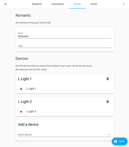

In OH3, I noticed that there is a set of widget/rule/etc. to manage scenes in OH but this doesn’t look as easy to configure as the scenes in HomeAssistant. OH3 is fantastic, but haven’t seen any major new features in the last couple releases. Is there any recent opinion on OH3.4 vs current HomeAssistant? Any specific feature I’d lose if I switched over HomeAssistant?

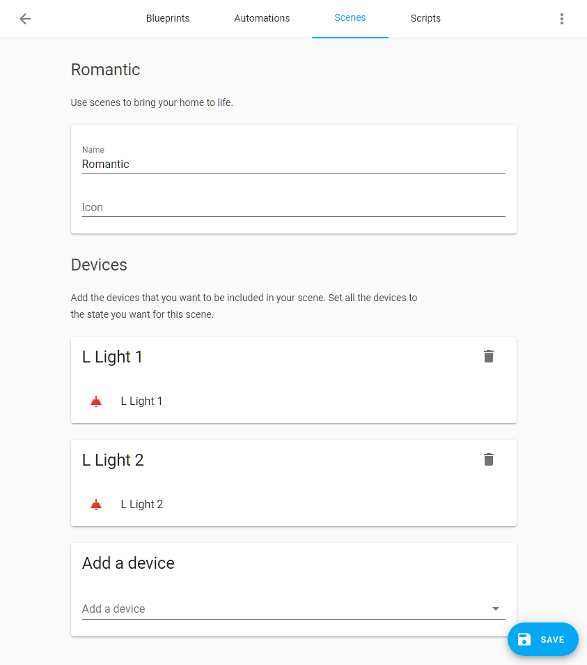

Again, I’m not pushing an agenda here, I’m trying to gather information. I haven’t used HA in forever, so I don’t know what this flow looks like from that perspective. Can you give an example. Just from a theoretical perspective, it’s hard to imagine that it’s really that much more efficient than using the rule wizard because that really does strip it down to a minimal number of clicks:

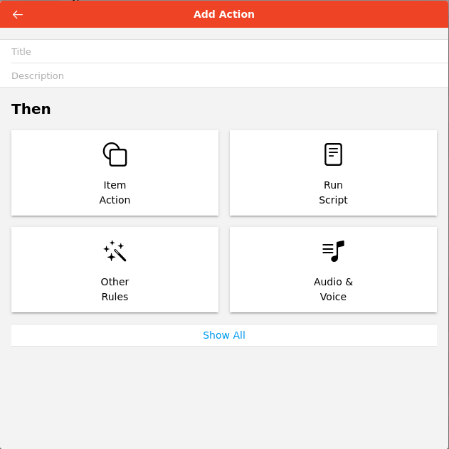

As for interaction with other rules, an OH rule can already interact with other rules as well via Add action and Other rules. Then your “Scene” can activate some other rule as part of the scene or be activated by some other rule.

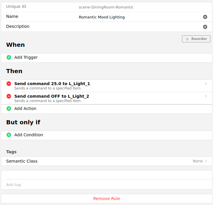

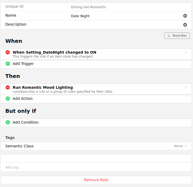

OK, in the interest of refining where OH might go, let me continue to play devil’s advocate here :smiling_imp::
This looks pretty much identical to what you’ve got:
And now, with the scene (rule) defined, I can control it from (other) rules:
Agree - I think your solution is super close. All it might need is some better organization inside the rules, like auto tag the scenes, put them somewhere else in the UI. Also I haven’t tested your widget yet, my only concern would be that the editor for a scene could be a bit fragile if you manually edit the rule that corresponds to a scene - vs having a native structure to store the presets.

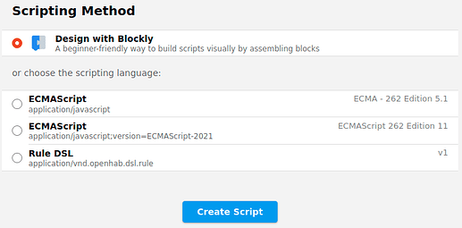

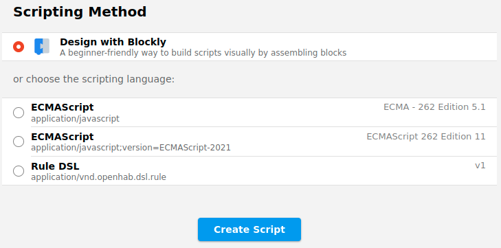

Available Rule Actions:
Available Script Actions:
Scripts are restricted to the “decision tree” subsection of rules without triggers. So, where is the “static item state” subsection of rules without triggers? Well that’s really what most users want to call scenes…

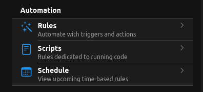

OK…
Rules… automate with triggers and actions
Scripts… rules dedicated to running code
Schedules… view upcoming time-based rules
What???

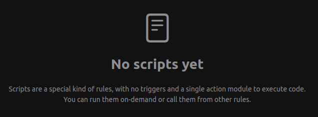

So what is a script???
clicky clicky
Scripts are a ‘special kind of rule’ with no triggers
How about, you write a rule, but you don’t create a trigger
You go to save your ‘Script’ (an ordinary rule but with no trigger) and it pops up a dialog box that says ‘you’ve created a rule with no trigger, it will only run if you call it from another rule’
Do you want to add a trigger? No, I just want some code to run from another rule or, whoa, ok, I’ll add a trigger
Scripts eliminated from UI, it is a redundant term in openHAB anyhow
