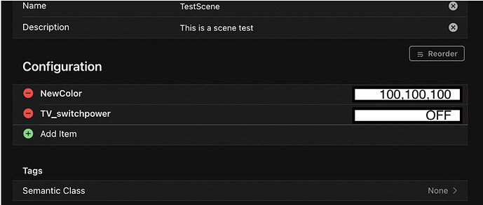

Bildschirmfoto 2022-10-07 um 20.06.20
Bildschirmfoto 2022-10-07 um 20.06.46
Bildschirmfoto 2022-10-07 um 20.07.02
Is that similar to what you would expect? If you don’t enter a “Command”, the current state will be used if you close the “Edit module” popup.
The the command field always a text entry? If so is there any way to put the text field on next to the Item instead of needing to click through to edit it?
Saving that extra click through could save a whole lot of user interaction. In those rarer cases where one wants to change the Item, I think deleting and adding a new one could fit that bill. I suspect changing out Items is a much rarer activity than wanting to adjust what the Items are commanded to.
Those are just my thoughts and not necessarily well thought out really. I’m just imagining wanting to adjust an already created scene and becoming annoyed at the extra clickthrough.
The command field should be similar to what you see in the rule editor when configuring an action module with an ItemCommandAction. Unfortunately the editor based on the item-type (e.g. color-picker) is not displayed at the moment and I couldn’t figure out why. This also doesn’t always work on my system for the rule editor, so I believe there is some general issue with that and probably @ghys might know why and how to fix it.
There’s 2 different UIs in the rules editor, a “wizard” of sorts when you add a new module (which can only add certain well-known module types, organizes them into 4 categories and has a tailored UI for some of them) and the generic module editor when you edit an existing one (which is a simple config sheet):
If you press “Show all” on the first screen of the “wizard” then you’re back to the regular module editor to configure the new module.
There’s no easy way to have the wizard UI for existing modules without some refactoring.
The scenes UI looks great, you could do the type check (or group’s base type) yourself and offer another input based on that - there are many options: https://v5.framework7.io/vue/inputs#examples
for example:
