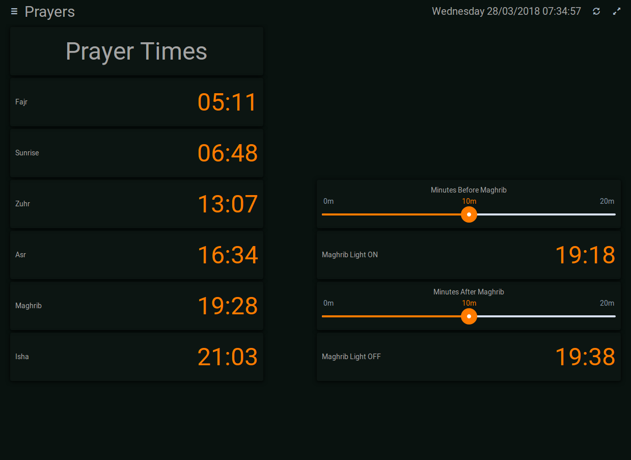

What do you want to do?
If you want to execute the script from openHAB, use the executeCommandLine action
If you want to display the prayer times, I currently use node-red and javascript
At every prayer time, for example, the adhan gets player on speakers, the tv pauses and display an image. Before and after Maghrib, the lights get turned on and off…

I used node-red to do the calculation and send the notifications to openHAB
