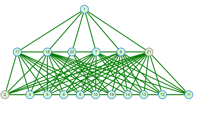

I have 18 devices. Here’s a screenshot of the ZWave network viewer in Habmin. Nodes 2 and 21 are the locks. I have no idea if this looks good or bad, so any guidance on looking at this would be appreciated. I have wondered if battery devices having all those “connections” was good or not. All the nodes are powered switches, except the 2 locks. I have one multisensor but it’s currently plugged in and not on battery.

My back door lock is a little further from the controller, but only by maybe 15 feet. I doubt that’s the issue, but at this point… :slight_smile:
I suggest disabling this, which is what I have done for all of my devices, since they all report on their own. Command polling is really just for devices that do not report their own state.
This looks good… no dead nodes and the locks have plenty of routing neighbors. Just realize, this is not displaying routes… just neighbors (the devices can see each other).

I was thinking that i shouldn’t see the delays i was seeing from time to time, as well as sometimes the lock not reporting back it’s state after a command/actuation. I only saw one of the locks not report back it’s state intermittently(node 2) so this lead me to believe maybe it was a ZWave issue. I’ll do some reading on ZWave before i ask too many more questions about that though. I did enable DEBUG logging, but when i realized i had to be up for work in 5 hours i had to cease and desist, LOL.
Just FYI, my BE469 (not the Plus model) also seems to lose a RAW message now and then. It’s not frequent, but it is irritating. I’ve placed other nodes very close by which maybe helped a little bit, but did not solve this. (Close means within 1 to 3 feet with no walls in between.) I have no other known issues in my network. This happens infrequently enough that I think turning on the debug log would be too much - it may not occur again for another month or more.
Most of the time this is benign, but I use the unlock on the keypad to turn off the alarm system, and when that doesn’t go through family members get upset as the alarm starts sounding. (Go back outside, lock the door, unlock again, and you’ll be fine…)
