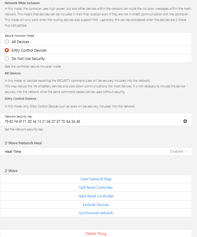

At this point, I removed the zwave stick from the windows computer and plugged it into the server. I changed the network key on the zwave bridge thing on OpenHAB to match the one I used on the windows device.

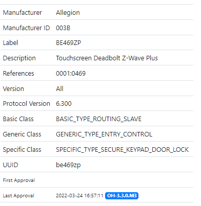

I’m starting to think that possibly that “GET_SCHEME” reason might be due to it not being in the database? It does say this lock is supported, but could it be possible that because I’m in Canada it’s reporting a different model number?
I’m also in Canada (Victoria, BC), but my lock is an older BE469. I’m pretty sure that others in Canada have added the BE469ZP, but it’s quite possible that something minor has changed and it needs to be added to the database as a new version.
When you added it, it should have generated an XML file that you can look at to compare the device ID fields with the database. If yours is different, you can submit a new version. Here are the detailed instructions.
https://opensmarthouse.org/blog/zwave_device_database_guide
When you search the database, the manufacturer is Allegion (Schlage’s parent company). Easiest thing is to search for “BE469”.
Seems a little odd to me that there’s no “First approval” timestamp, and the “Last approval” timestamp was in March. So maybe something did change recently?

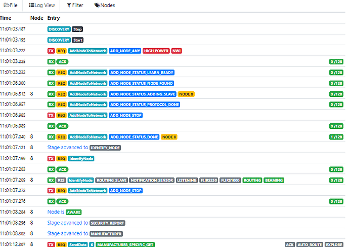

My top line recommendation is to try to include the device from the OH server while the zwave is in debug mode. (The steps for Debug are at the bottom of the zwave documentation under the heading “When things do not go as planned. Also at the very last line there is a link to a Zwave Debug log viewer). I’m expecting to capture additional information as to why 'Get_Scheme” is failing. Since others have apparently included this lock with the binding something should be found.
Prior to this attempt, use the PC controller to ensure there are no remnants of prior attempts on the zstick (Check failed/remove failed) and that the lock is factory reset. Once on the Scan page, start Debug, start Scan and perform the lock inclusion protocol. Stop Debug after about 20 seconds. In the log viewer it should look something like this (Except no Node is awake message & something more on Security.

Edit: make sure the security key is 16 bytes
