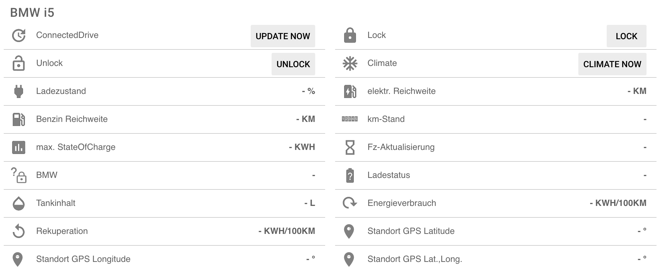

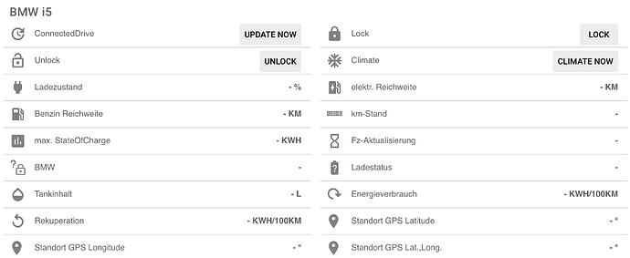

I tried this as suggested: VEHICLE_API = 'https://b2vapi.bmwgroup.us/api/vehicle'
then, since it didn’t work, tried this as well: AUTH_API = 'https://customer.bmwgroup.us/gcdm/oauth/authenticate'
doesn’t see to do the trick… I still just see this in the site map:
Openhab log just has this in it:
2019-01-18 14:27:44.815 [INFO ] [ipse.smarthome.model.script.bmwcdapi] - forced connectedDrive API call
2019-01-18 14:27:46.583 [INFO ] [ipse.smarthome.model.script.bmwcdapi] - …running bmwcdapi.py
