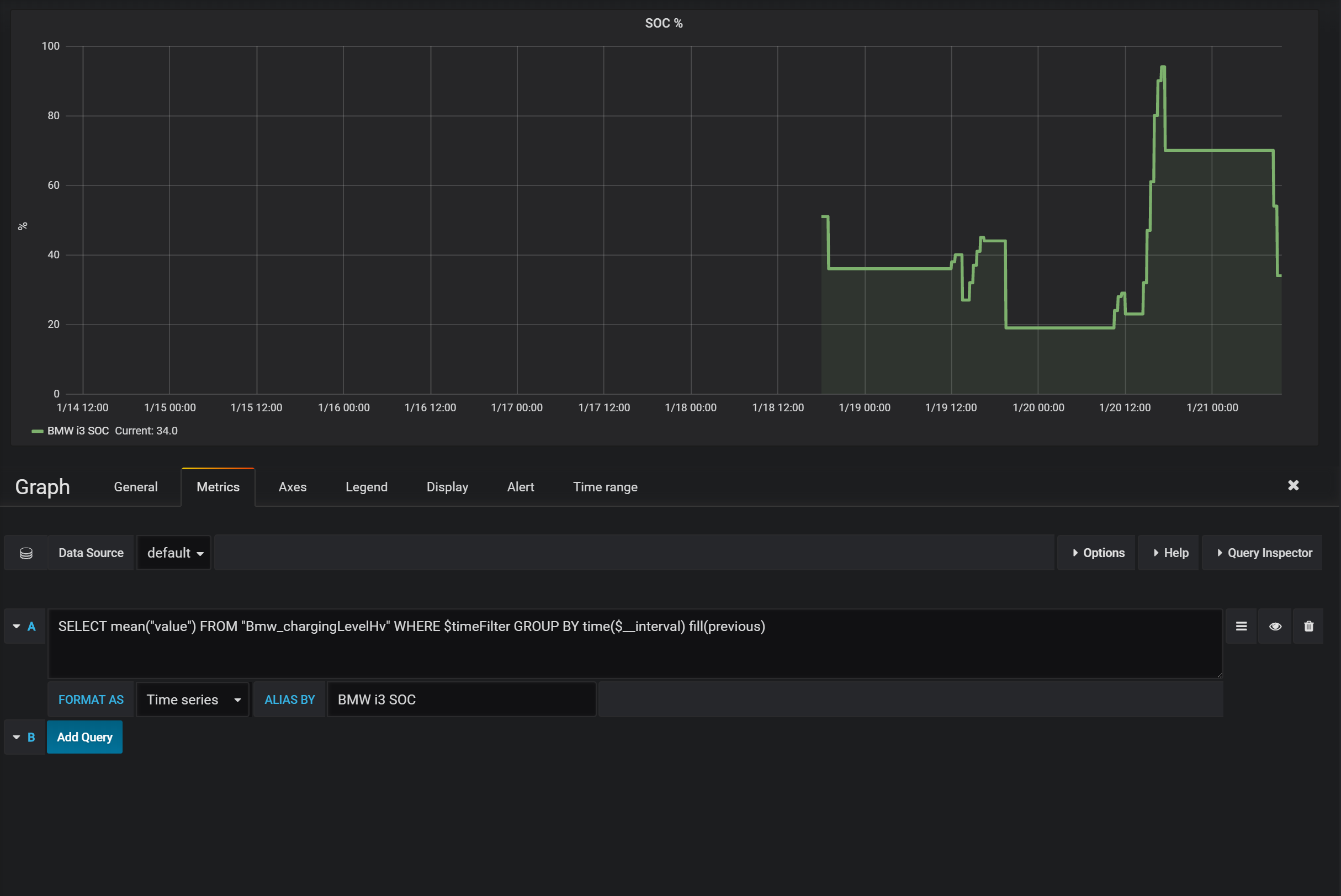

@xsherlock, can you please share how you configured the SOC chart.
Sure, it is made in grafana, you need to install grafana/influx combo first. There is a megathread on that issue but the instructions from the first post work.
Then it is just adding two queries for SOC and daili trip.
The SOC chart in attached screenshot is cut as I was on the long holidays and did not drive the car.
Thank you, I started working on it, but it seems like an uphill battle for an openhab newbie.
You can set up nice looking charts in HABPanel (it comes with openHAB) within minutes.
Of course these charts are limited compared with grafana, but I think for the first it is sufficient.
