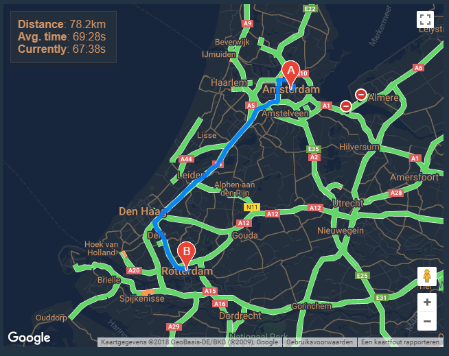

NEW 2018-02-27: Added distance and travel time calculation between two locations. It calculates the avarage travel time, and with current traffic conditions. Import the new widget and get the new ‘maps.html’ file.
I’ve created another widget for HABpanel. For me it’s handy to check the current traffic conditions prior to go to work. Therefore I created an widget that uses Google Maps API and displays the current traffic on the map. It auto reloads the traffic on 10 seconds interval.
I’ve also used the Night color schema so it better fits the default theme of HABpanel.
Screenshot:

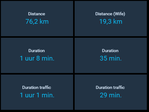

If you wan’t, you can get google Maps travel times ext. in a Item and display it in Dummy widgets.
  • Install HTTP binding thru PaperUi / Add-Ons
  • Install JSONPath transformation thru PaperUi / Add-Ons
Create a ‘googlemaps.items’ file in ‘/conf/items’. Change the value’s in the URL to your liking.
String	GoogleMaps_me_distance				"Distance [%s]"		(gGoogleMaps)	{ http="<[https://maps.googleapis.com/maps/api/distancematrix/json?origins=Amsterdam&destinations=Rotterdam&language=NL&departure_time=now&traffic_model=best_guess&mode=driving&key=YOUR_API_KEY:3600000:JSONPATH($.rows[0].elements[0].distance.text)]" }
String	GoogleMaps_me_duration				"Duration [%s]"		(gGoogleMaps)	{ http="<[https://maps.googleapis.com/maps/api/distancematrix/json?origins=Amsterdam&destinations=Rotterdam&language=NL&departure_time=now&traffic_model=best_guess&mode=driving&key=YOUR_API_KEY:3600000:JSONPATH($.rows[0].elements[0].duration.text)]" }
String	GoogleMaps_me_duration_traffic		"Duration [%s]"		(gGoogleMaps)	{ http="<[https://maps.googleapis.com/maps/api/distancematrix/json?origins=Amsterdam&destinations=Rotterdam&language=NL&departure_time=now&traffic_model=best_guess&mode=driving&key=YOUR_API_KEY:3600000:JSONPATH($.rows[0].elements[0].duration_in_traffic.text)]" }
String	GoogleMaps_wife_distance			"Distance [%s]"		(gGoogleMaps)	{ http="<[https://maps.googleapis.com/maps/api/distancematrix/json?origins=Amsterdam&destinations=Haarlem&language=NL&departure_time=now&traffic_model=best_guess&mode=driving&key=YOUR_API_KEY:3600000:JSONPATH($.rows[0].elements[0].distance.text)]" }
String	GoogleMaps_wife_duration			"Duration [%s]"		(gGoogleMaps)	{ http="<[https://maps.googleapis.com/maps/api/distancematrix/json?origins=Amsterdam&destinations=Haarlem&language=NL&departure_time=now&traffic_model=best_guess&mode=driving&key=YOUR_API_KEY:3600000:JSONPATH($.rows[0].elements[0].duration.text)]" }
String	GoogleMaps_wife_duration_traffic	"Duration [%s]"		(gGoogleMaps)	{ http="<[https://maps.googleapis.com/maps/api/distancematrix/json?origins=Amsterdam&destinations=Haarlem&language=NL&departure_time=now&traffic_model=best_guess&mode=driving&key=YOUR_API_KEY:3600000:JSONPATH($.rows[0].elements[0].duration_in_traffic.text)]" }
3600000 in milliseconds = update every hour. Please be aware of your API usage so you stay in the free zone. This is your own responsibility.
More Google Maps API options here.
Add a Dummy widget for every String. You can set it up like this:
I’m not going to build a custom widget as it’s just plain simple displaying strings.

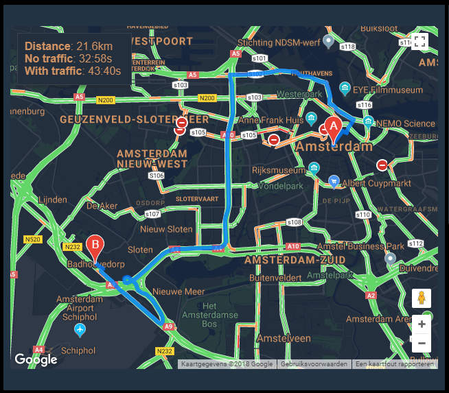

What do you think about this. You can set orgin and destination. It will then draw the prefered route on the map. It will calculate the distance, travel time and travel time with current traffic. It will update, every 10 seconds and recalculates the best route, and travel times.
Any remarks about the text box displaying the info?
