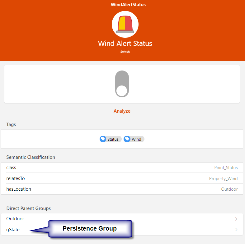

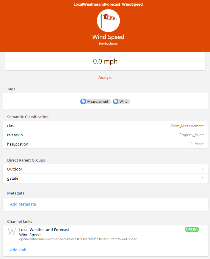

Create Switch Item: Wind Alert Status item should look something similar to the screen shot below. Go ahead and “initialize” the item by toggling the switch ON then OFF. This will setup the correct initial state.
Add this item to your preferred persistence mechanism to maintain the state of your “switch” after a reboot.

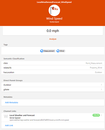

Create Wind Speed Item: Wind Speed after linking a new item to the Wind Speed channel

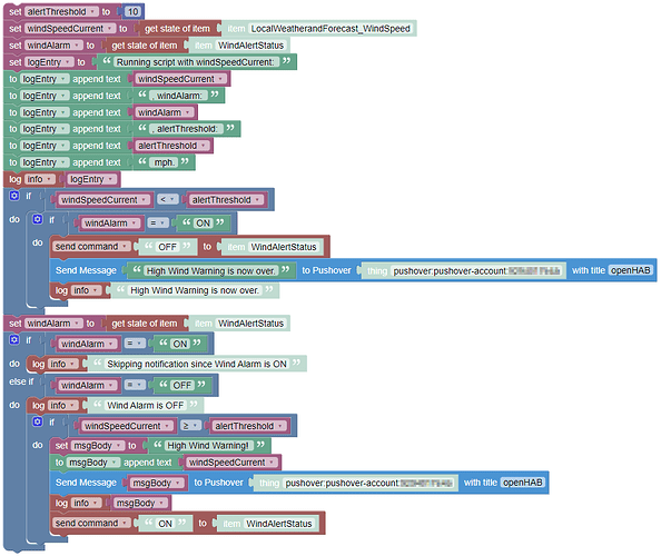

The Script
- From the Settings > Scripts menu click the blue + and create a new script using “Design with Blockly”
- Give it a name such as “High Wind Monitor”
- Reproduce the blocks as shown in the examples below
- Or click the “Code View” button and copy & paste the example code, then save

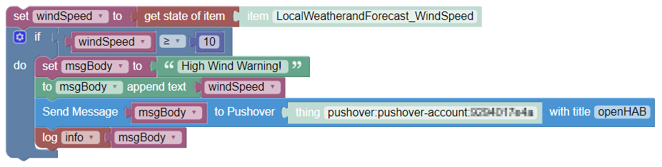

Version 1
Initial version created with Blockly to test rule trigger, getting the item value, and sending Pushover message.
var windSpeed, msgBody;
var things = Java.type('org.openhab.core.model.script.actions.Things');
windSpeed = itemRegistry.getItem('LocalWeatherandForecast_WindSpeed').getState();
if (windSpeed >= 10) {
msgBody = 'High Wind Warning! ';
msgBody += String(windSpeed);
things.getActions(
'pushover',
'pushover:pushover-account:*********').sendMessage(
msgBody,
'openHAB'
logger.info(msgBody);

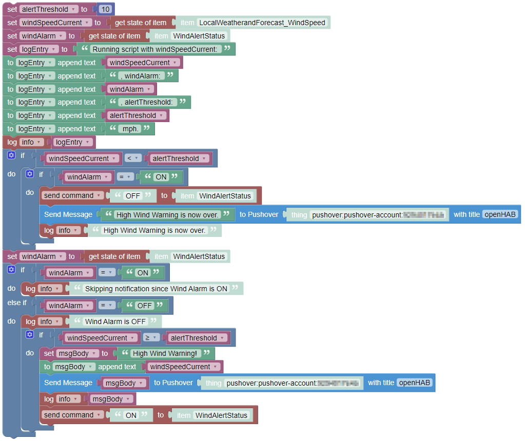

Version 2
Enhanced revision to meet all of the functional requirements.
var alertThreshold, windSpeedCurrent, windAlarm, logEntry, msgBody;
alertThreshold = 10;
windSpeedCurrent = itemRegistry.getItem('LocalWeatherandForecast_WindSpeed').getState();
windAlarm = itemRegistry.getItem('WindAlertStatus').getState();
logEntry = 'Running script with windSpeedCurrent: ';
logEntry += String(windSpeedCurrent);
logEntry += ', windAlarm: ';
logEntry += String(windAlarm);
logEntry += ', alertThreshold: ';
logEntry += String(alertThreshold);
logEntry += ' mph.';
logger.info(logEntry);
if (windSpeedCurrent < alertThreshold) {
if (windAlarm == 'ON') {
events.sendCommand('WindAlertStatus', 'OFF');
things.getActions(
'pushover',
'High Wind Warning is now over.',
'openHAB'
logger.info('High Wind Warning is now over.');
logger.info('Skipping notification since Wind Alarm is ON');
} else if (windAlarm == 'OFF') {
logger.info('Wind Alarm is OFF');
if (windSpeedCurrent >= alertThreshold) {
msgBody += String(windSpeedCurrent);
things.getActions(
'pushover',
msgBody,
'openHAB'
events.sendCommand('WindAlertStatus', 'ON');

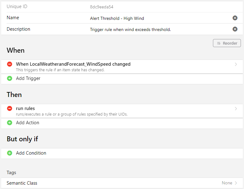

The Rule
Create a Rule to trigger the script whenever the ‘LocalWeatherandForecast_WindSpeed’ is updated.
- Choose When an item state changes
- Select the wind speed item ‘LocalWeatherandForecast_WindSpeed’
- Under the Then section click “Add Action” > Other Rules > run these rule(s) and select the script “High Wind Monitor”
Example:

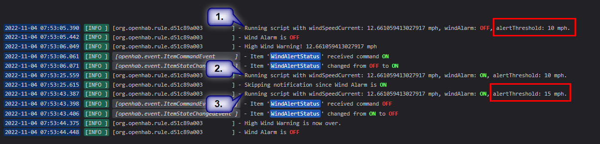

Rule logging in openHAB Log Viewer (frontail):
2022-11-04 07:25:29.922 [INFO ] [openhab.event.ItemStateChangedEvent ] - Item 'LocalWeatherandForecast_WindSpeed' changed from 0 mph to 12.661059413027917 mph
2022-11-04 07:25:30.046 [INFO ] [org.openhab.rule.d51c89a003 ] - Running script with windSpeedCurrent: 12.661059413027917 mph, windAlarm: OFF, alertThreshold: 10 mph.
2022-11-04 07:25:30.064 [INFO ] [org.openhab.rule.d51c89a003 ] - Wind Alarm is OFF
2022-11-04 07:25:30.618 [INFO ] [org.openhab.rule.d51c89a003 ] - High Wind Warning! 12.661059413027917 mph
2022-11-04 07:25:30.629 [INFO ] [openhab.event.ItemCommandEvent ] - Item 'WindAlertStatus' received command ON
2022-11-04 07:25:30.636 [INFO ] [openhab.event.ItemStateChangedEvent ] - Item 'WindAlertStatus' changed from OFF to ON

Testing
Test the script logic by modifying the threshold value below the current wind speed. Monitor the event log output to make sense of what is going on.
Example
- Edit Blockly
alertThresholdvalue to be less than the current wind speed. Click Run, and observe log output - Click Run again and note that the switch
WindAlertStatusis already ON and no alerts are sent - Raise the threshold above current wind speed and confirm warning is reset and switch
WindAlertStatusis set to OFF
