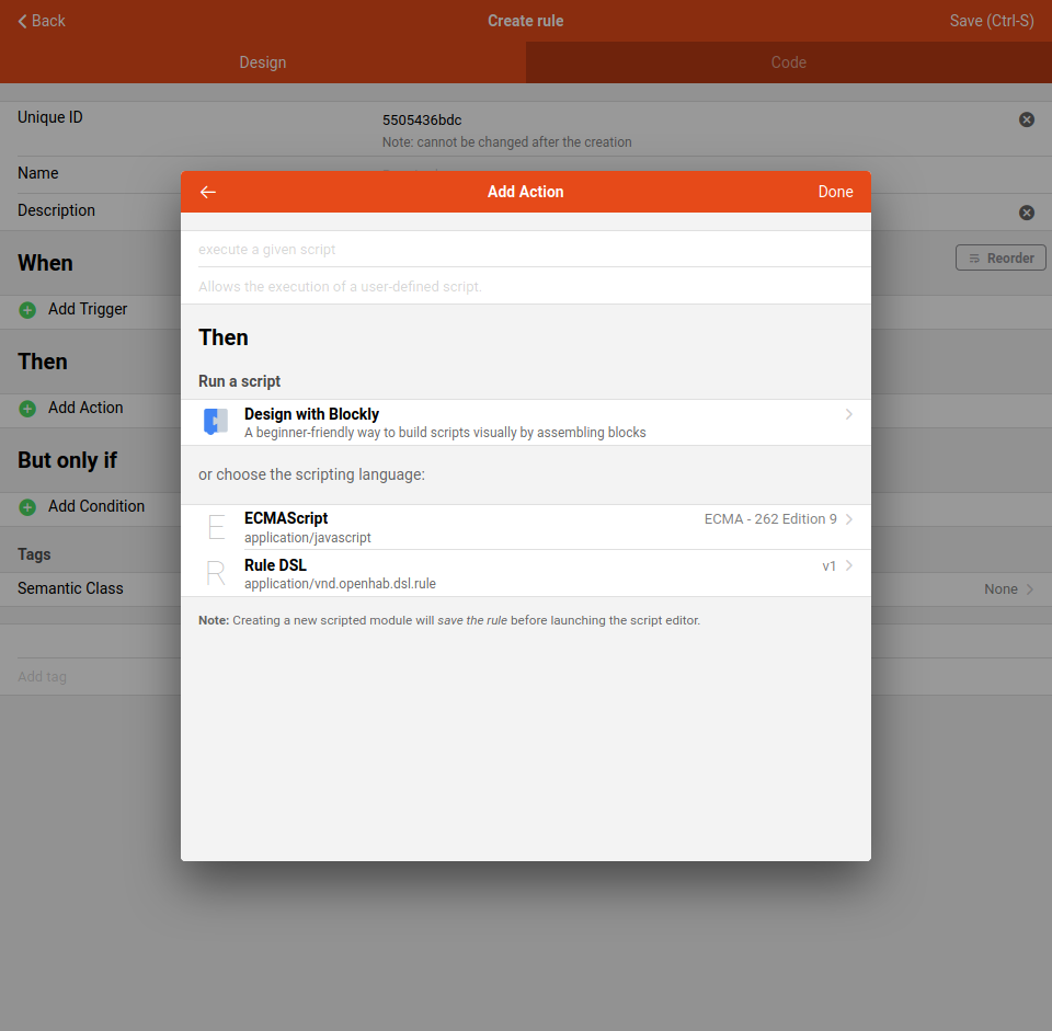

From this description I was under the impression that I would be given the choice between three scripting languages, as in this screenshot (sorry, the forum won’t let me embed it).

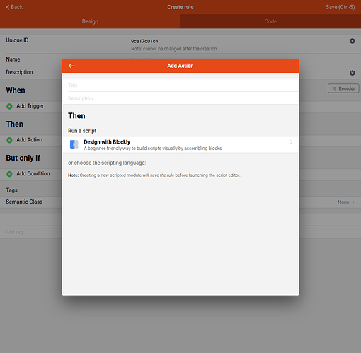

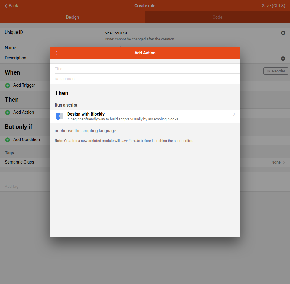

But unfortunately this is all I get:
I would be most grateful for any pointers as to what I might be doing wrong.
If I choose the Blocky option (the only available), I don’t think it’s supposed to look like this either?
That’s just a plain text editor window.
There is something significantly wrong. At a minimum you should have a choice between ECMAScript and Rule DSL after “or choose the scripting language”.
