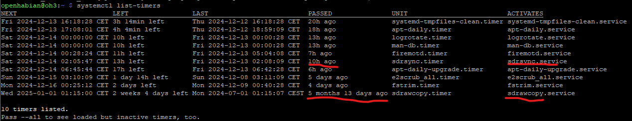

I have recently established SD Backup using build in function
It seems to be working because checking the status of the timers i see when the last sync had place:
I decided to simulate a crash and one day i placed backed up SD card in the slot hoping the system starts up and will have no changes in the system configurations. 1:1 behaviour and setup.
