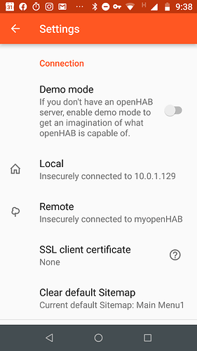

Now I would naively assume that the app uses the certificates provided by OpenHab. But in the screenshot you notice that the lokal connection is unsecure and the SSL certificate is not set.
Furthermore, I receive a warning during the first connection that the certificate is not valid due to wrong server name in the certificate.
Is this the expected behaviour?

It is because it’s only http traffic. This is completely fine if it happens only in your local network and you trust everyone using it.
This is the setting for client certificate.
Because it is a self signed certificate by your server. You accept it if you are sure that it’s from your server.
Yes :+1:
“Insecure” will disappear if you configure a reverse proxy with https and authentication. However in you local network, you don’t need to do this.

This my question too. It looks like Android app needs a certificate installed. Where do I get this? Here are some screen shots.

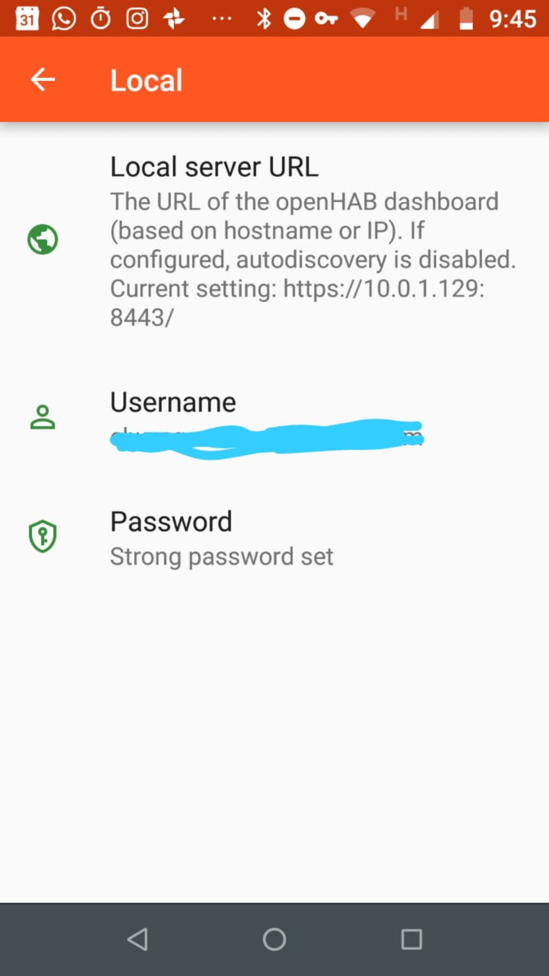

Here is my second screen shot.

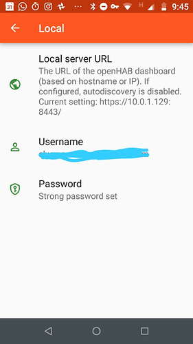

Can you make a screenshot of the preference subpages (local and remote)? You should redact the user name before posting.

Did you change something? Or does it still show “Insecurely connected to myopenHAB” on the main settings page?
No.
Still the same. It says “Insecurely connected” but it’s not connected like I explain in the next post.

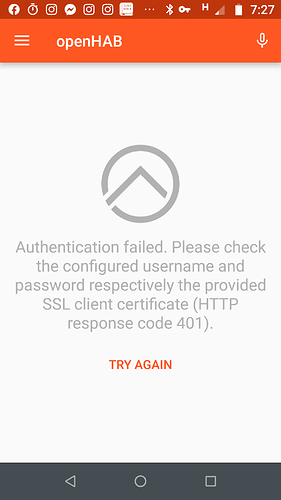

I am adding this info in hopes it will shed more light on it. On my phone I can login fine to myopenHAB.org using a browser but not with the app. This is what I get when trying to connect remotely.
There’s a bug that causes all connections shown as insecure: Fix connection summary always set to insecure by mueller-ma · Pull Request #1649 · openhab/openhab-android · GitHub
