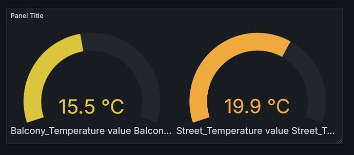

how can I display only the lowest measured value in grafana?
background, we have 2 outdoor sensors
the first one is processed by the sun in the morning until midday and the second one from the afternoon until the evening.
But now I only want to see the lowest value in the gauge display.
from(bucket: "openhabian")
  |> range(start: v.timeRangeStart, stop: v.timeRangeStop)
  |> filter(fn: (r) => r["_measurement"] == "Balcony_Temperature" or r["_measurement"] == "Street_Temperature")
  |> filter(fn: (r) => r["_field"] == "value")
  |> aggregateWindow(every: v.windowPeriod, fn: mean, createEmpty: false)
  |> yield(name: "mean")
Thank you
