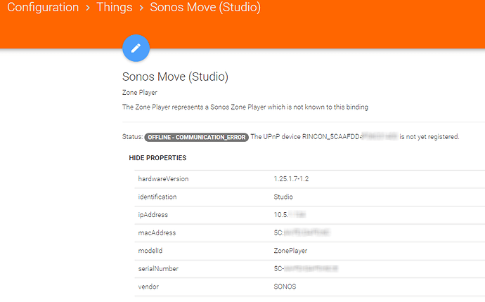

I have a couple of SONOS devices that have gone offline.
They were fully discovered previously, yet they are now offline. All of the channels show in PaperUI. It’s not all of my units, only 2 of 8.
Any thoughts?

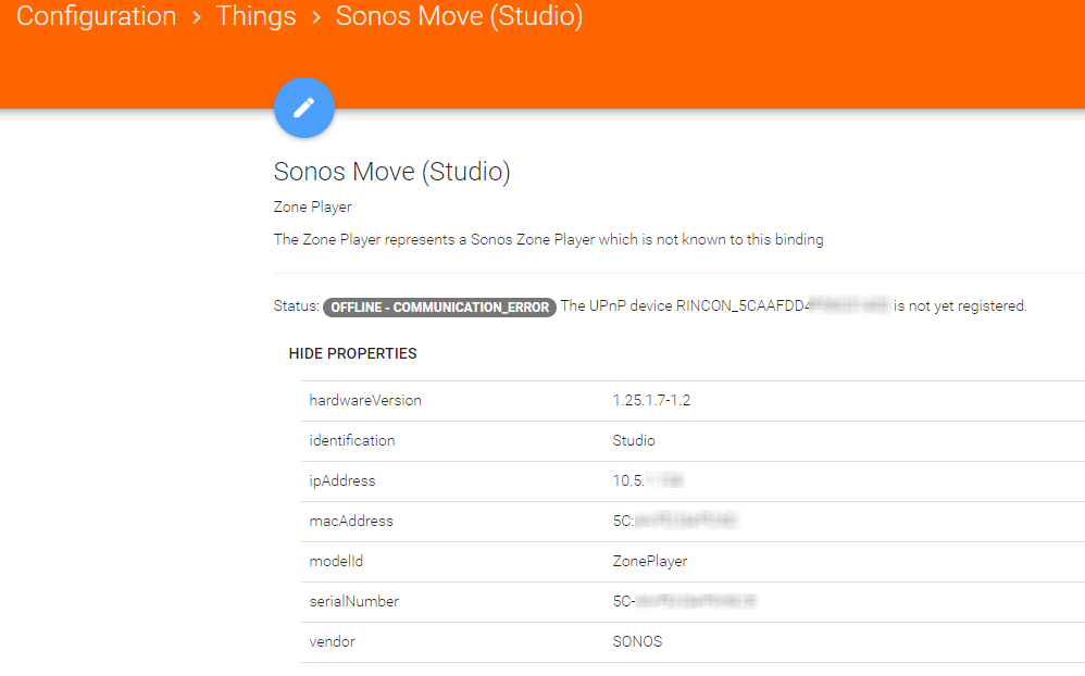

Any thoughts?
If your using a newer version of the Samsung binding, it causes Sonos devices to be pushed off the network.
Samsung 2.4 RC1 works with Sonos.
Best, Jay
All Samsung bindings removed as none would control my tv.
