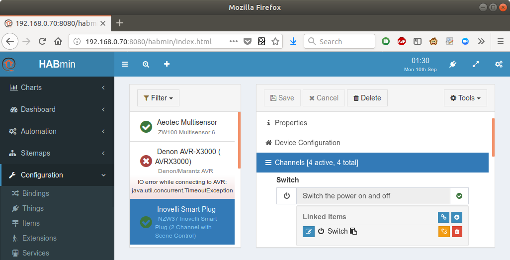

Maybe not that part in particular… But it’s really frustrating not being able to copy-paste the very long names that are auto assigned to Items when you auto-discover them in the UI given the fact that you pretty much have to textually enter them many times to create rules and such.
For example:
Screenshot_2018-09-10%20Screenshot
I found an option to “Copy” the Item name here, but it doesn’t work:
Screenshot%20from%202018-09-10%2001-30-12
If you use this “copy” button it pops up a message saying the item name was copied to clipboard, but nothing is actually copied.
