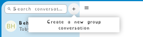

  1. Open up the Talk pane
  2. Click on the + button next to the chat search box:

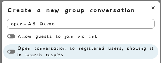

  3. You will be asked to name the conversation and select some options for it. I leave both the options off, as I do not want others to be able to post messages to this chat.
  4. Click on the Add Participants button on the bottom of the dialog and search for the user you created for your OH instance. When you have at least one user selected to add to the conversation, you can click to Create Conversation button.
This will create the conversation, take you to the conversation’s chat window and, most importantly, assign the conversation an ID. The conversation ID is the 8 character alpha-numeric code at the end of the url displayed in your browser while the conversation is open. For example, with the url:

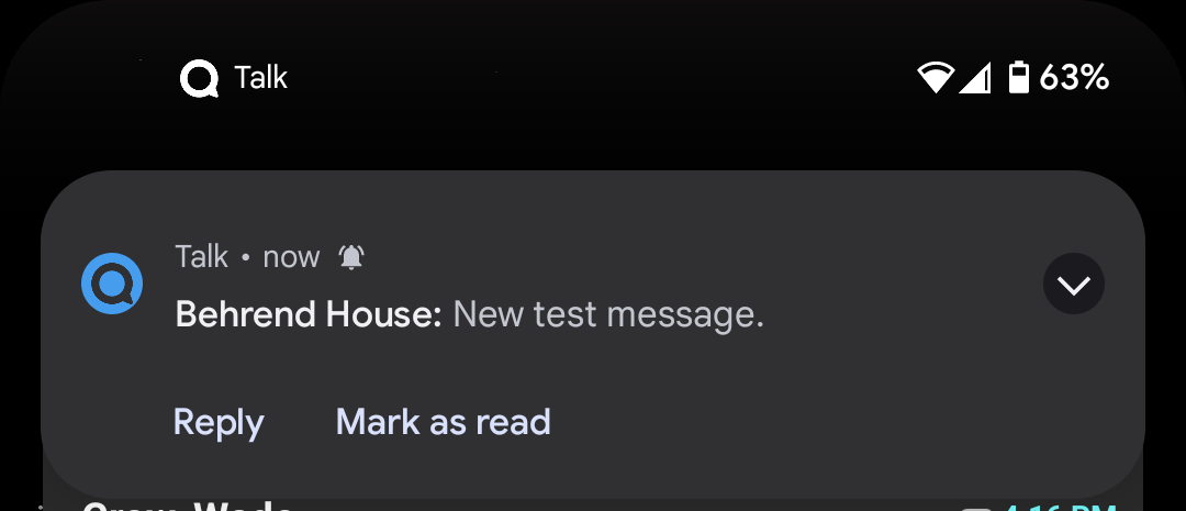

And on a mobile device with the Talk app installed, I get a notification of this chat message:

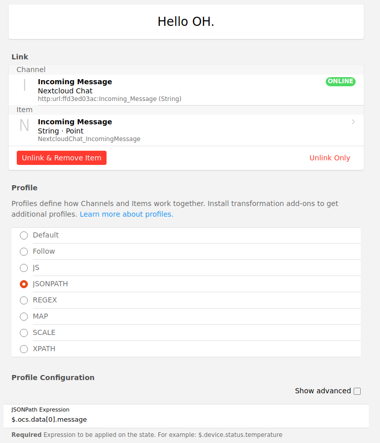

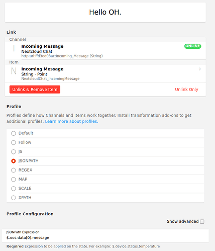

However, as with the send payload, the returned value for this call is a JSON string, although, in this case, it contains a lot more than just the message text.

I don’t transform this returned value at the level of the channel. Instead I do so with a JSONPATH profile for the linked items. This gives me the ability to have individual items for different parts of the message. For example, here’s a String Item linked to this channel that extracts just the message text:
