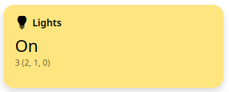

There is no (practical) limit to the number of groups an item can be added to. I solve this issue by simply creating 1 additional group for each aggregate data point that I want. For example, my light card:
This tells me that there are 3 lights on overall, and that 2 of them are on the second floor and 1 on the main floor. Each of those numbers comes from a group with an aggregation function. For example the total number group:
This information will not be inlcuded on the autogenerated location cards, but you can create (as I have here) your own widget to display it however you want.
