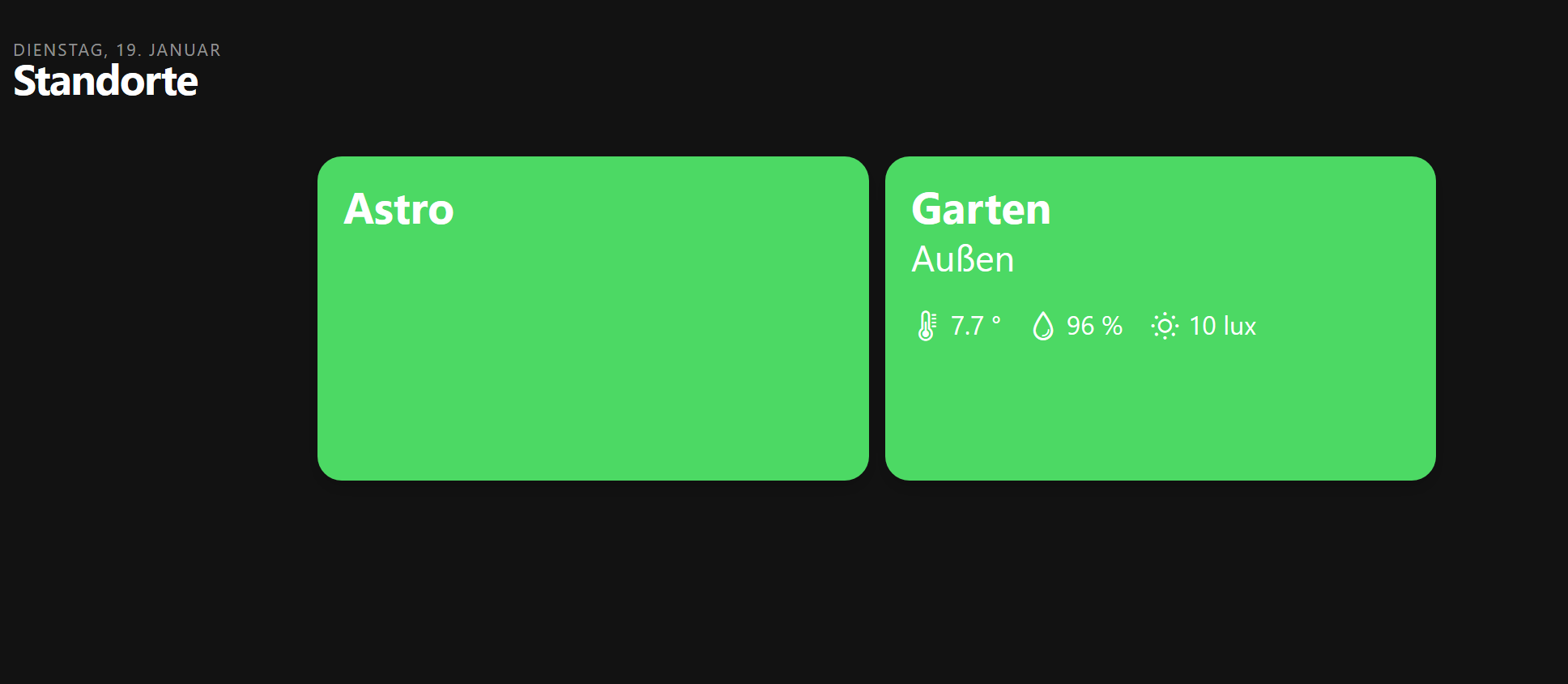

I followed the tutorial “[[OH3] Semantic Model setup via tags in configuration Items files]” and set up my item files to populate the semantic model. That worked well as shown followed
Unfortuantly that works only for the Astro items. I also tried it with my hue items. With no success for the location indoor.

I want to have my semantic model populated by the item file. Furthermore the main UI page for location should show for example “indoor > ground floor > kitchen > Switch”

My items show up in the semantic model. But no item tile show up in the MainUI. I tested to add only one group to the item. I also cleared the cache. I made a complete new item file for the groups. But the tiles don’t show up, if I define them from file. Everything is shown in the semantic model within Settings Menu.
