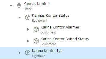

1st solution (preferable) - Get badges and locations card properties data to work and display from subequipment:

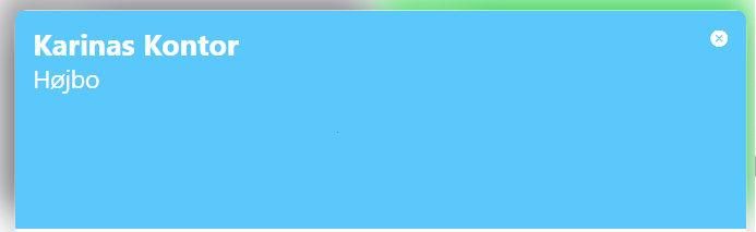

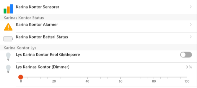

So I can group things that don’t need direct interaction or is read-only, like sensors, alarms, low battery warnings etc. like the image below
But when I add these alarms, and battery status as subequipment to get the view I want when opening a locations card, the location card does not display the badge icons on the card, ie. no temperatures, lights etc.

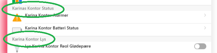

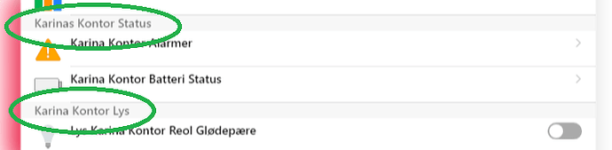

2nd solution would be to populate the location card properties, by putting items directly under the location, but then I’d very much like to divide the tab into segments for the different properties, like it is shown under the equipment tab:
So is there a way to get the green marked separators in the properties tab of a location card?
Instead of just this long list

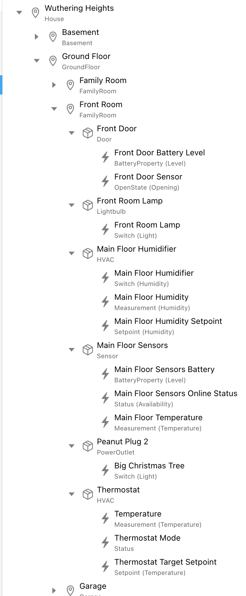

Here is an example of one of my locations and how it looks on the locations card:
As you can see, I have no point Items that are directly under the Location. They are all members of an equipment.
The Location card appears as follows:
As you can see, badgets appear and the Points are separated by the Euqipment they belong to.
Perhaps you can compare the semantic tags you are using compared to the ones I’m using and find a difference.

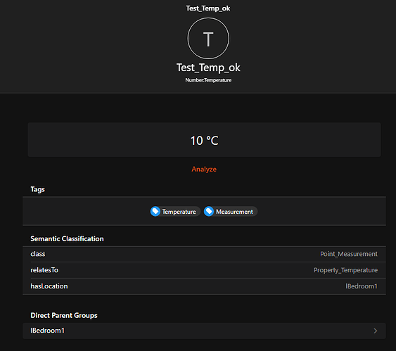

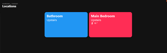

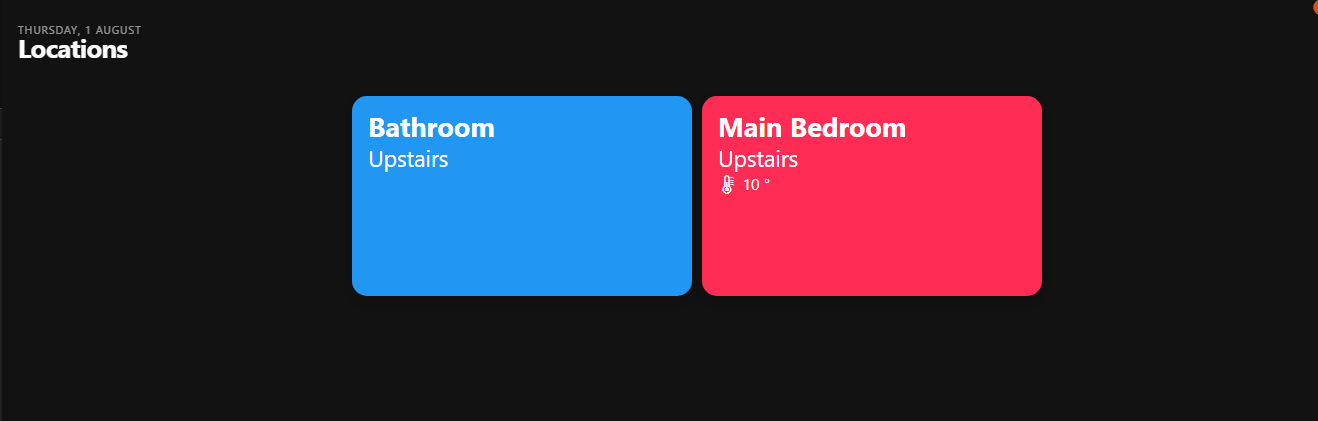

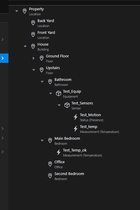

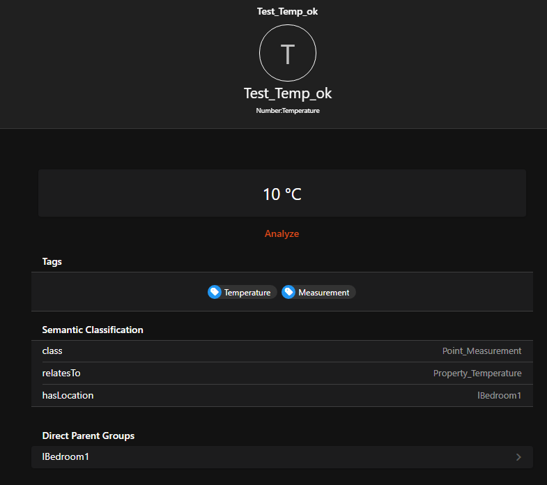

I’ve used 2 items - test_temp which is part of a sub-equipment,
and test_temp_ok which is part of an equipment, like in your model.
The only thing that isn’t in this mock setup are actual channel links to a Thing, but that I’m confident should not make any difference.
