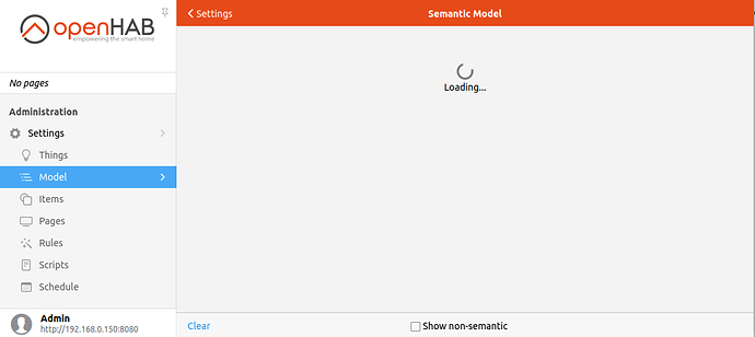

I’m running a (probably) pretty average openHAB installation (~60 things, ~500 items, ~30 rules). Since a couple of weeks (the precise time is hard for me to pin down), the loading time of the “Semantic Model”-page went up dramatically, usually between 20 - 30 seconds. Loading time of the “Items”-page is ~4 seconds (pretty normal I’d say).
Whenever this happens, this is what htop shows:
I found these two threads here ([SOLVED] OH3 Issue - "Model" Page endless loading - Maximum call stack size exceeded in app.js - #25 by pat281 and [SOLVED] OH3 Issue - "Model" Page endless loading - Maximum call stack size exceeded in app.js - #30 by plainspace), but they talk about endless loading, so I believe this is something different.
The loading times are similarly high when calling the “model tree” elsewhere in openHAB, e.g. when creating a new item and selecting the Parent.
Everything else appears to be working normal. openHAB log (default log level) does not show any errors. The loading times are also independent from the browser (tried on Firefox as well as iOS/Safari).
Does anyone have a clue on how to find the root cause?
