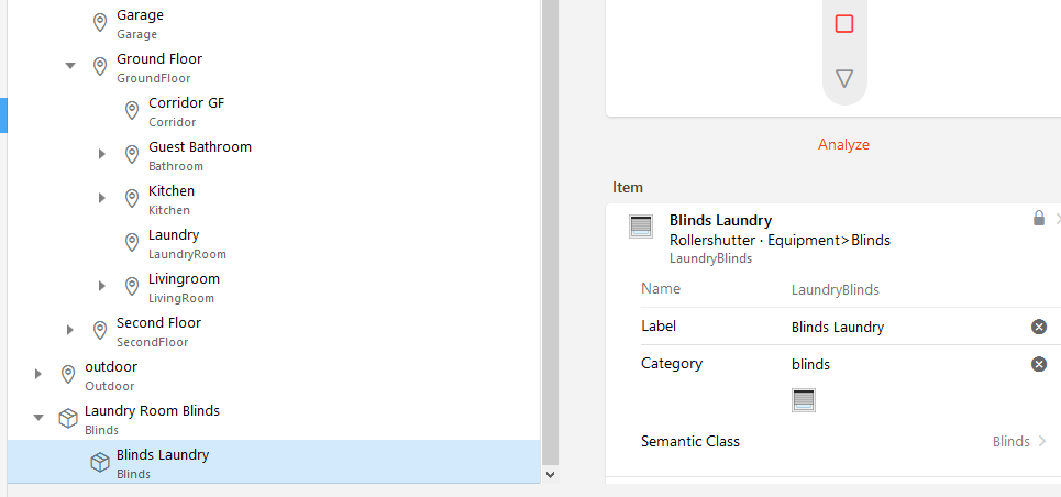

Group gLaundryroom  "Laundry"  <washingmachine>  (gGroundFloor) ["LaundryRoom"]
Group  gLaundryBlinds  "Laundry Room Blinds"  (gLaundryroom)  ["Blinds"]
Rollershutter   LaundryBlinds   "Blinds Laundry"  <blinds> (gLaundryBlinds, gBlinds)     ["Blinds"]  {channel="zwave:device:....l"}

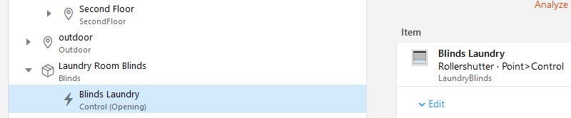

shows up in the UI:
It’s really strange and seems to me that this is a random error as the equipment that’s not displayed correctly changes every now and then.
Sometimes it helps to change the group names back and forth. But the “laundry error” persists (it popped up after a restart of OH3 without changing anything).
Have you defined any part of the Semantic Model using only the UI? That can cause unpredictable things to happen after a restart…
Also Blinds is an Equipment type, which you’ve used twice here - so you’re trying to add an Equipment to an Equipment to a Location: is that what you meant to do? It’s not wrong, but there’s no Points/Properties here.

Isn’t the Rollershutter a Point? How would you do it?
No, it’s not, but you haven’t defined it as a roller shutter Point either. You have used
which is an Equipment type, so openHAB will treat it as an Equipment.
Have a look at the list linked from that tutorial to see what you can use for Points.
You could maybe try ["Control","Opening"]. I don’t have a roller shutter though, so haven’t tried.
You’re right! Didn’t think about it. I’m still struggling with the semantic model.
But anyway: tried that straight away… no success

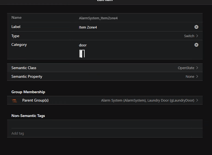

I have the same issue on some of my items.
They show correctly in locations.

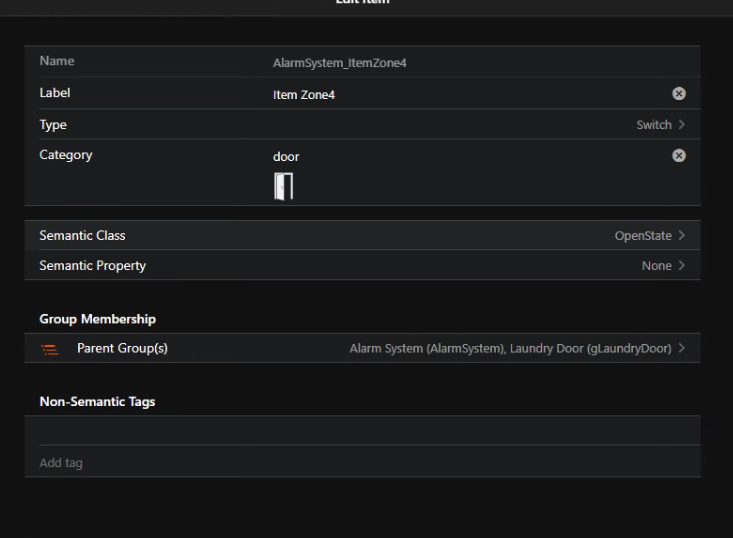

One of my doors has group alarm system. and laundry.
Shows only in laundry
It’s not the same issue.
An item can’t be a member of 2 equipment groups at the same time.
Only one parent equipment and/or location.
ah. gotcha.
So can be a member of multiple locations? but only one equipment?
No, at most one location, or one equipment, or both.
Follow the arrows, there can be only one relationship of each type.
