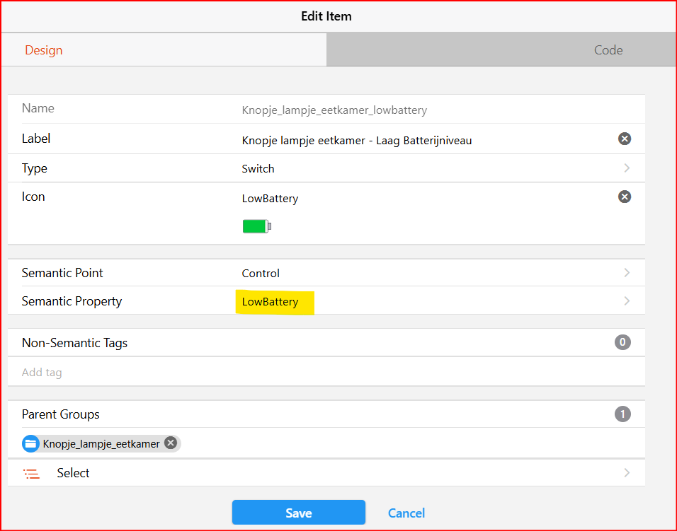

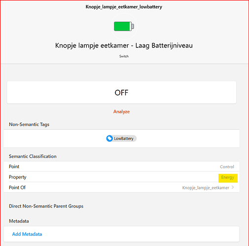

Semantic tags: invalid combination of two Properties - UI confusion
label: Knopje lampje eetkamer - Laag Batterijniveau
type: Switch
icon: LowBattery
groupNames:
  - Knopje_lampje_eetkamer
tags:
  - Energy
  - LowBattery
I understand that I can delete one of both Properties from the code, but I find the UI quite confusing…
If you click on the Semantic Property in the UI an make a selection, it will only save a single one. The UI is built as to not allow selecting 2, but if there are 2 from another source (or from the change in the semantic class going from 4.3 to 5.0 as is the case here), it will not reflect that.

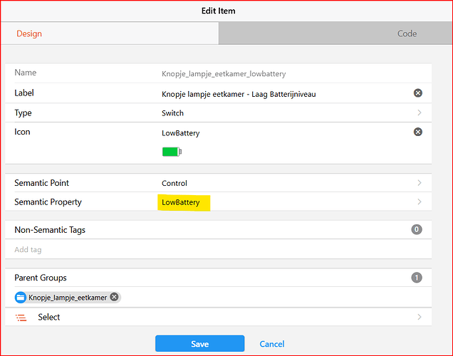

I am having the same issue (like 50+ times) but if I go to the item, then code view to remove the wrong tag, I cannot save it - it throws a 500 error - weird thing is, all items were made in OpenHAB 4.x manually through the UI.
What if you select the correct tag via the GUI?
Yeah that does it - seems it will be a manual process for now, my steps:
  1. Click to edit
  2. Click Semantic Location
  3. Select None
  4. Close
  5. Notice it still shows a value
  6. Click it again
  7. Now make the correct selection
  8. Save
