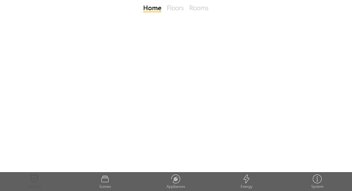

Anyway, since upgrading to 5.0, my “Security” tab shows nothing. I tried the code found on @hmerk’s GitHub (semanticHomeMenu/main/semanticHomeMenu.yaml at main · hmerk/semanticHomeMenu · GitHub & semanticHomeMenu/security/semanticHomeMenu_Security.yaml at main · hmerk/semanticHomeMenu · GitHub), and this is the result:

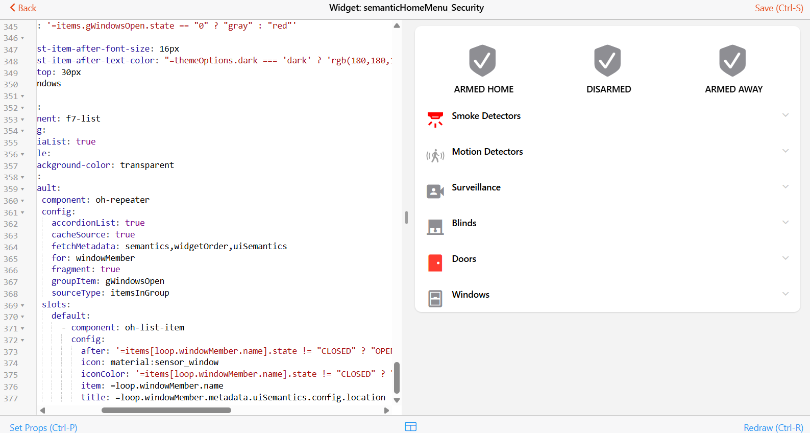

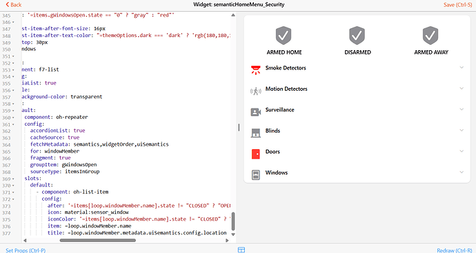

It works in the widget preview though:
I tested this with Google Chrome as well as Firefox…
Does anyone have a clue?
