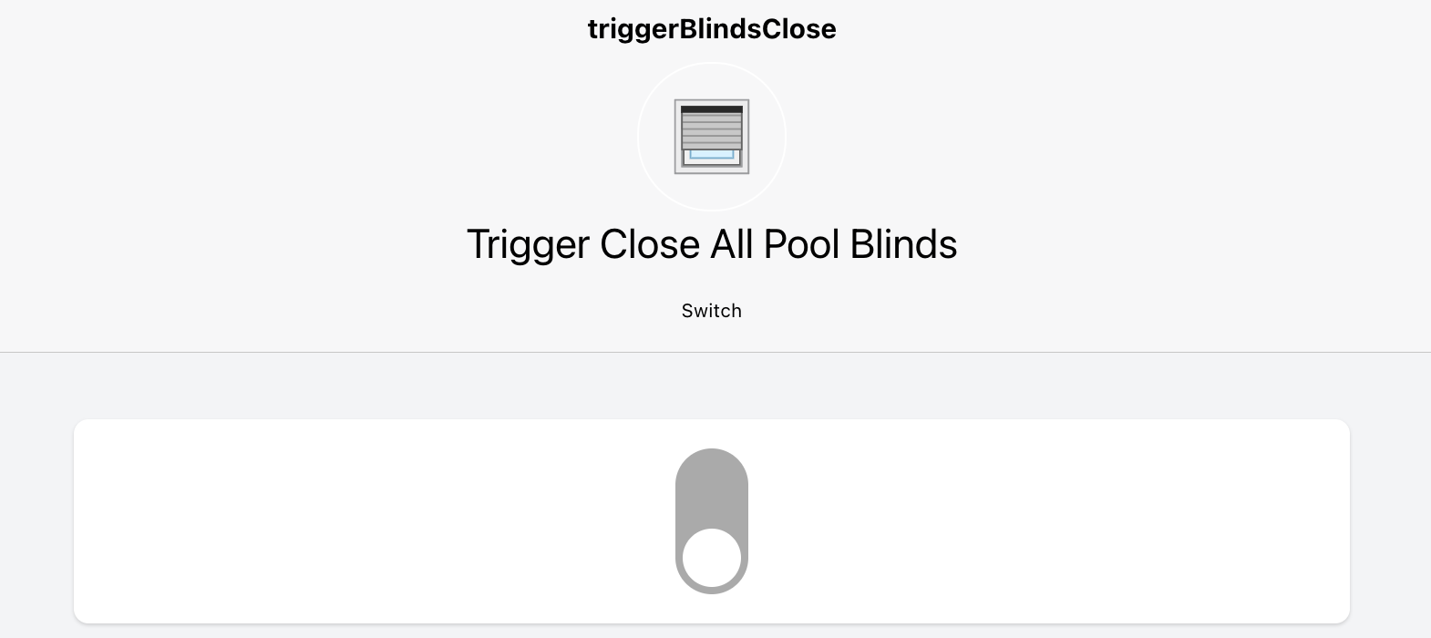

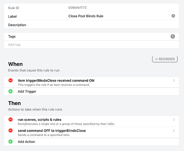

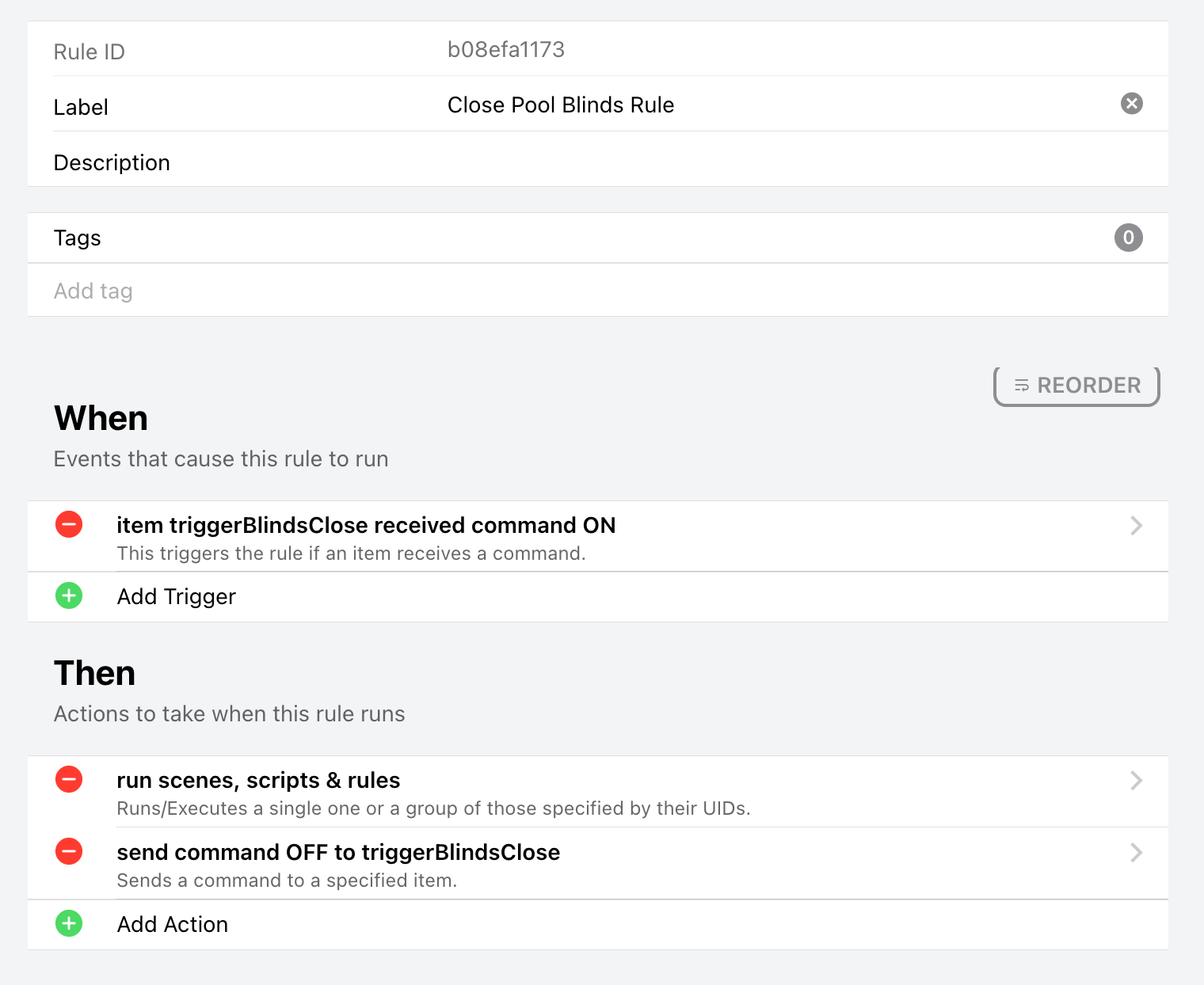

Rather than a dummy string item, i created a dummy switch which works well. I created a rule that runs when the switch is set to ON which i do via the Elgato button using McControl. Example of one below to close all my blinds:
Dummy Switch Item:
Rule:

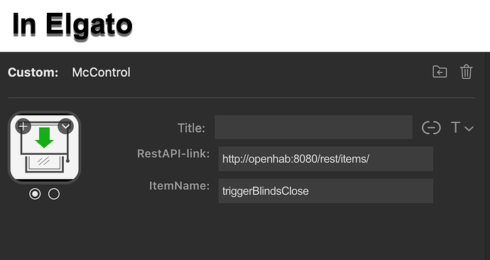

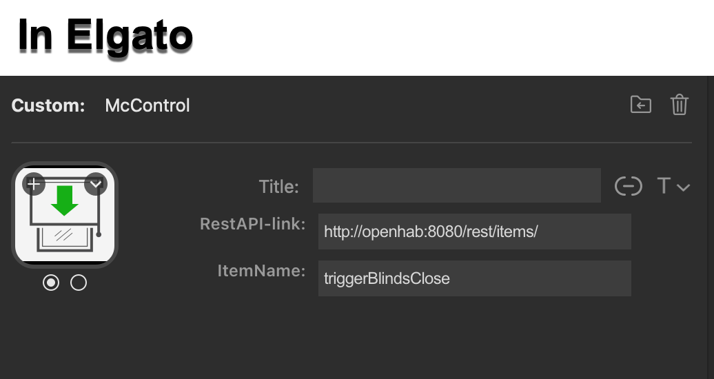

The McControl widget in Elgato sends an ‘ON’ or an ‘OFF’ to the item depending on the current state reported in Elgato.
It sometimes takes a while for the status to update on the Elgato button - but the triggering of the rule is pretty instant.
