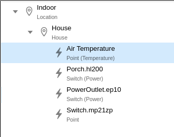

Tracking the log:tail I don’t see anything and the temperature in my generic thing doesn’t change.
How do I figure out the topic name ? It seems that what I am using is wrong. I don’t know how to determine the correct topic parameter.
That seems to be the openhab channel id, not an mqtt topic. You’re confusing the two.
You need to find out what that openhab channel’s MQTT Topic first, (stateTopic). Then you publish your message using that topic using mosquitto_pub
